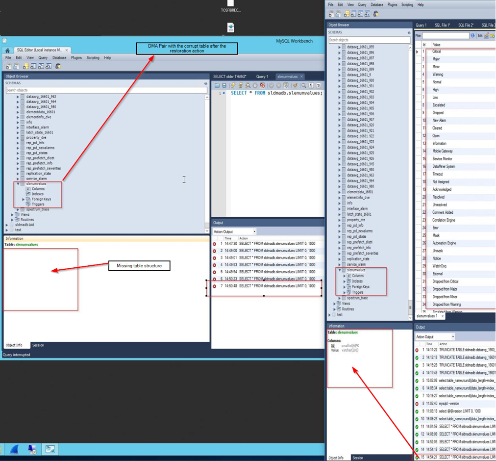

  5. Log back into MySQL Workbench, navigate to SLDMADB and check the table structure and content. If possible, compare with the DMA for an accurate view. For example, in the image below, selecting the SLEnumvalues table reveals that the table structure is missing. To confirm this, try querying the data and check if the query fails.
    MySQL Workbench example

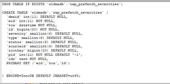

      Consult the structure of the table in the workbench to structure your query correctly.
      Table structure example

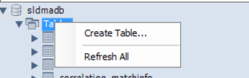

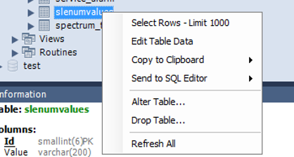

    • Alternatively, you can use the workbench to create the table:
      Create Table option in MySQL Workbench
      Table context menu in MySQL Workbench
