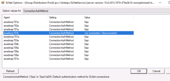

To resolve the issue without restarting the DMA, update the ConnectionAuthMethod setting on the affected Agent:
  1. Open the SLNetClientTest tool and connect to the DMA that displays the error log.
  2. Navigate to Advanced > Options > SLNet Options.
  3. In the dropdown list next to Option values for, select ConnectionAuthMethod.
  4. On the Agent that is marked as disconnected, double-click the value field.
  5. Enter Sspi as the new value.
  6. Click OK.
