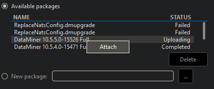

  4. If you are able to connect to the DataMiner Agent:
    1. Go to System Center > Agents.
    2. Right-click the Agent you launched the upgrade from, and select Upgrades.
    3. In the pop-up window, right-click the package you used to launch the upgrade and select Attach.

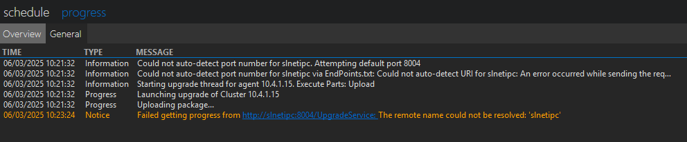

During a DataMiner upgrade, no progress events are shown, but instead the following message is repeatedly shown:
Failed getting progress from http://slnetipc:8004//UpgradeService: The remote name could not be resolved: 'slnetipc'

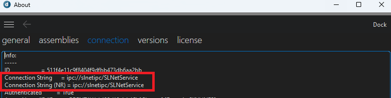

This happens when the upgrade is launched in a DataMiner Cube session connected via localhost. You can verify this in Cube by clicking the user icon in the upper-right corner and selecting About. In the connection tab of the About window, look for Connection String or Connection String (NR). If either or both says ipc://slnetipc/SLNetService, this issue will occur.
