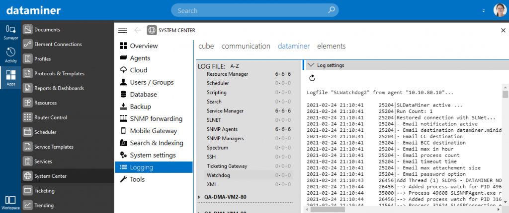

Accessing Watchdog logging
There are two ways to access the Watchdog logging:
  • In DataMiner Cube, go to System Center > Logging > DataMiner, select the DMA for which you want to see the logging, and select Watchdog in the list of files on the left.
  • On the DMA, go to the folder C:\Skyline DataMiner\Logging and open the SLWatchdog2.txt file.
Watchdog logging in DataMiner Cube (version 10.1.0)
