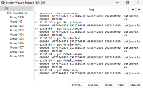

The Stream Viewer window consists of two panes:
  • On the left is a tree view that can be used to filter the stream per connection, group or pair.
    From DataMiner 10.1.0 [CU22]/10.2.0 [CU10]/10.3.1 onwards, the Stream Viewer tree view supports more levels in case of HTTP communication.
  • On the right, the communication stream is displayed for the selected item in the tree view.
Stream Viewer
Stream Viewer in DataMiner 10.4.5
