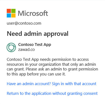

Make sure admin approval has been granted
When you want to log in using your existing corporate Microsoft account, the following notification may be shown:
Need admin approval
If you see this, you should contact your IT department, so they can approve the access to the required resources. They will only have to give consent once. When this is done, this message will no longer be shown.

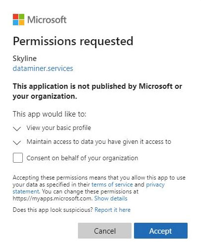

There are two options for your IT department to give consent:
  • They can go to dataminer.services and go through the normal process of registering an account.
  • They can use use the following link to directly give consent to our application:
    https://login.microsoftonline.com/{tenant-id}/adminconsent?client_id=2e25a456-a261-44cf-beb8-06da7f5199f5
    In this link, {tenant-id} is your organization's tenant ID or any verified domain name.
In both cases, it is important to select the checkbox Consent on behalf of your organization. Selecting this also automatically allows access for regular users in the organization.
Request for permissions
If the window shown above is not displayed, make sure an account is used that has the Global Administrator role in Azure.
