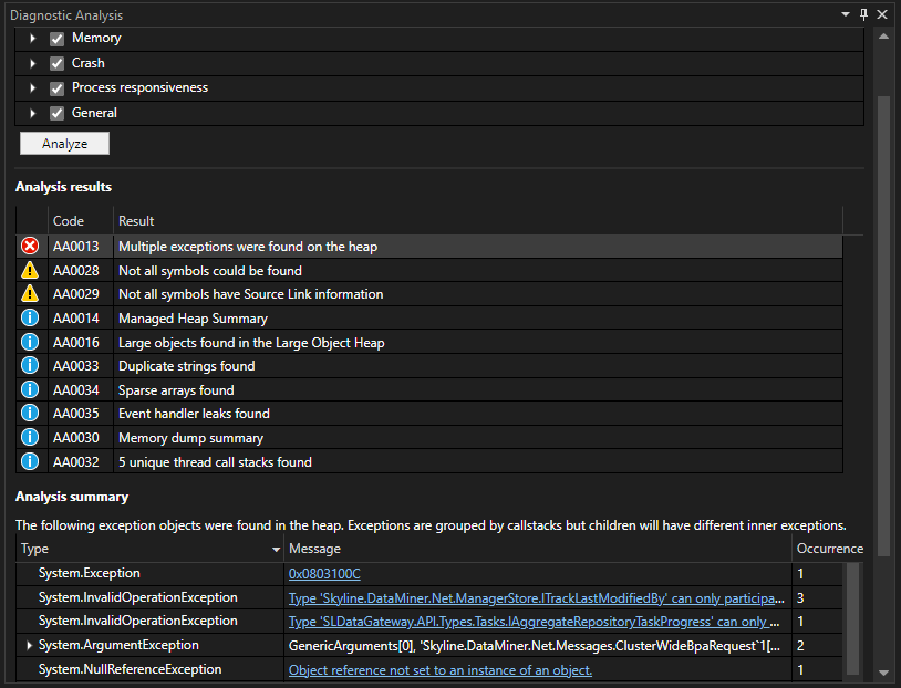

  1. Open the SLManagedScripting dump file in Visual Studio, and click the Run Diagnostic Analysis link in the Actions list.
    The Analysis results pane should show that an exception was found on the heap:
    Analysis results
    Visual Studio Analysis results
    In this case, it mentions that a NullReferenceException was found.

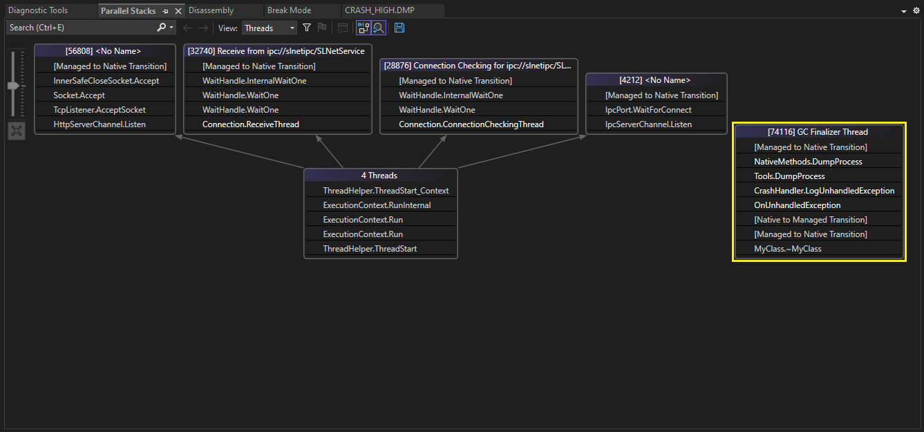

  2. Open the Parallel Stacks window (Debug > Windows > Parallel Stacks):
    Visual Studio Parallel Stacks window
    This shows that an unhandled exception occurred on the Finalizer thread (OnUnhandledException) while executing the Finalizer of MyClass (~MyClass).
