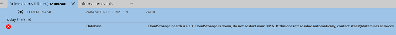

STaaS is unreachable
If STaaS is unreachable for some reason, the following error message will be shown in the Alarm Console:
Error in Alarm Console
DataMiner will automatically initiate offload mode, ensuring that no data loss occurs. While this error is displayed in the Alarm Console, do not restart the system or any of its elements.
This issue typically resolves itself.
