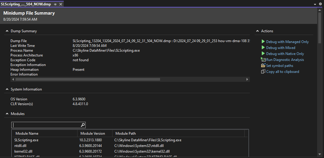

Once you have a .dmp file (either extracted from the Log Collector package or created by another tool), you can investigate it using Visual Studio:
  1. In Visual Studio, go to File > Open > File (or press Ctrl + O).
  2. Select the .dmp file and click Open.
    An overview of the Minidump File Summary will be shown:
    SLScripting Minidump File Summary

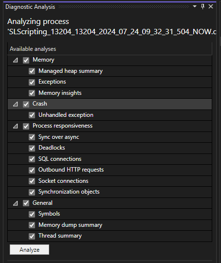

  3. In the Actions overview, click Run Diagnostic Analysis.
    This will open the Diagnostic Analysis window.
  4. Make sure all memory-related checkboxes are selected and click the Analyze button.

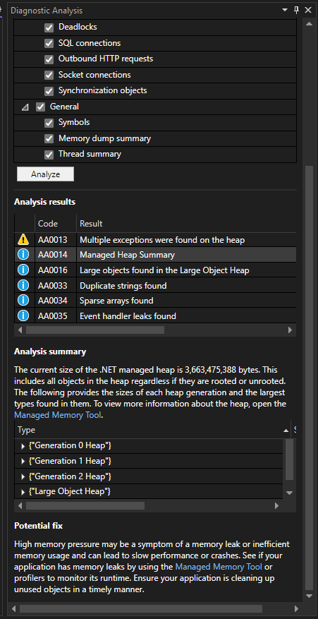

    Once the analysis is complete, the analysis result will be shown in the window:
    Diagnostic Analysis window results
  5. In case the analysis result contains an entry Managed Heap Summary, click the entry to see more information.
  6. If the summary mentions the following potential fix, click the Managed Memory Tool link:
    High memory pressure may be a symptom of a memory leak or inefficient memory usage and can lead to slow performance or crashes. See if your application has memory leaks by using the *Managed Memory Tool* or profilers to monitor its runtime. Ensure your application is cleaning up unused objects in a timely manner.

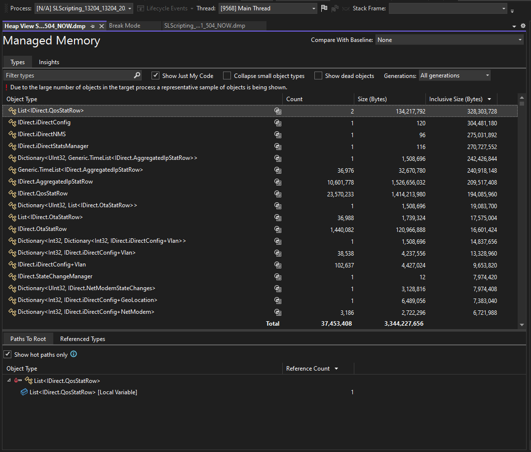

    Clicking the link will process the managed memory and give you an overview of the types of objects present in managed memory together with their size:
    Managed Memory results
    Based on this overview, you can investigate the objects consuming the most memory to get a better understanding of what is consuming the memory.
In some cases, it could be that the analysis result does not show this potential fix and therefore does not provide a link to open the Managed Memory Tool. In that case, use another tool to inspect the managed memory, such as the Dump Analyzer Server (link for Skyline employees only), Memory Dump Analyzer SLScripting (link for Skyline employees only), or WinDbg.
If you cannot identify any objects that are responsible for consuming the memory in managed memory, keep in mind that it is also possible that the leak is present in unmanaged memory. In this case, review whether objects are used that implement IDisposable and that were not properly disposed of, and verify whether you use code or class libraries that allocate unmanaged memory that was not properly released.
