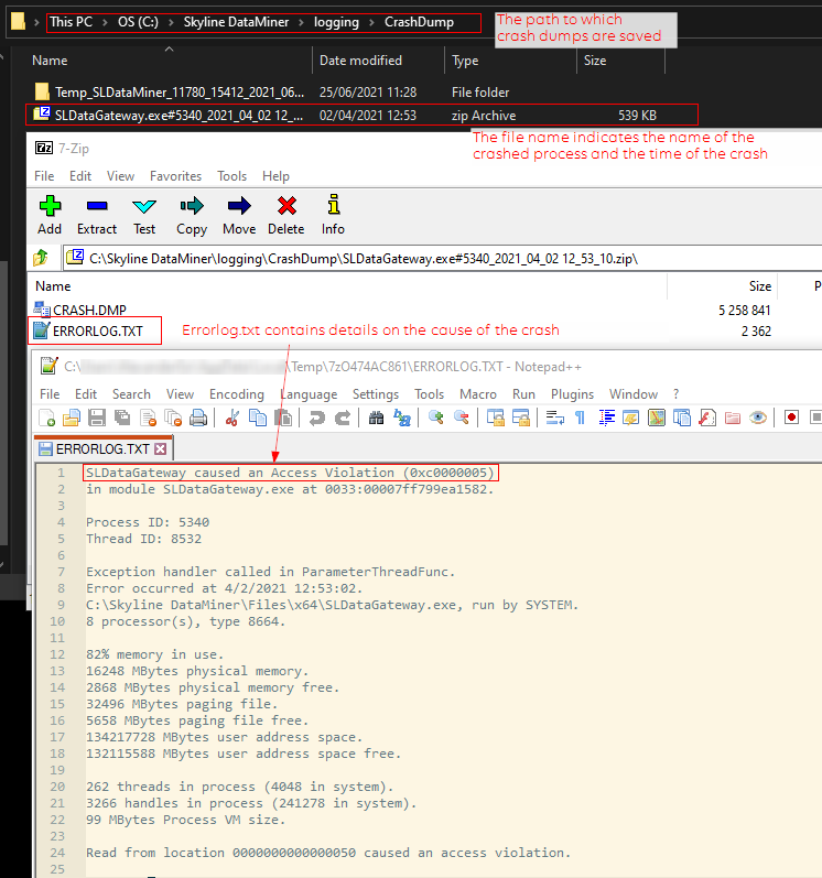

Check if new files are present in the folder C:\Skyline DataMiner\logging\CrashDump. Files are created in this folder when an unexpected disappearance of a DataMiner process occurs.
Note the names of the processes if there are any. If a crash dump is saved correctly, you will have details on the exception that occurred in the ERRORLOG.TXT file inside the package.
Example:
ERRORLOGTXT

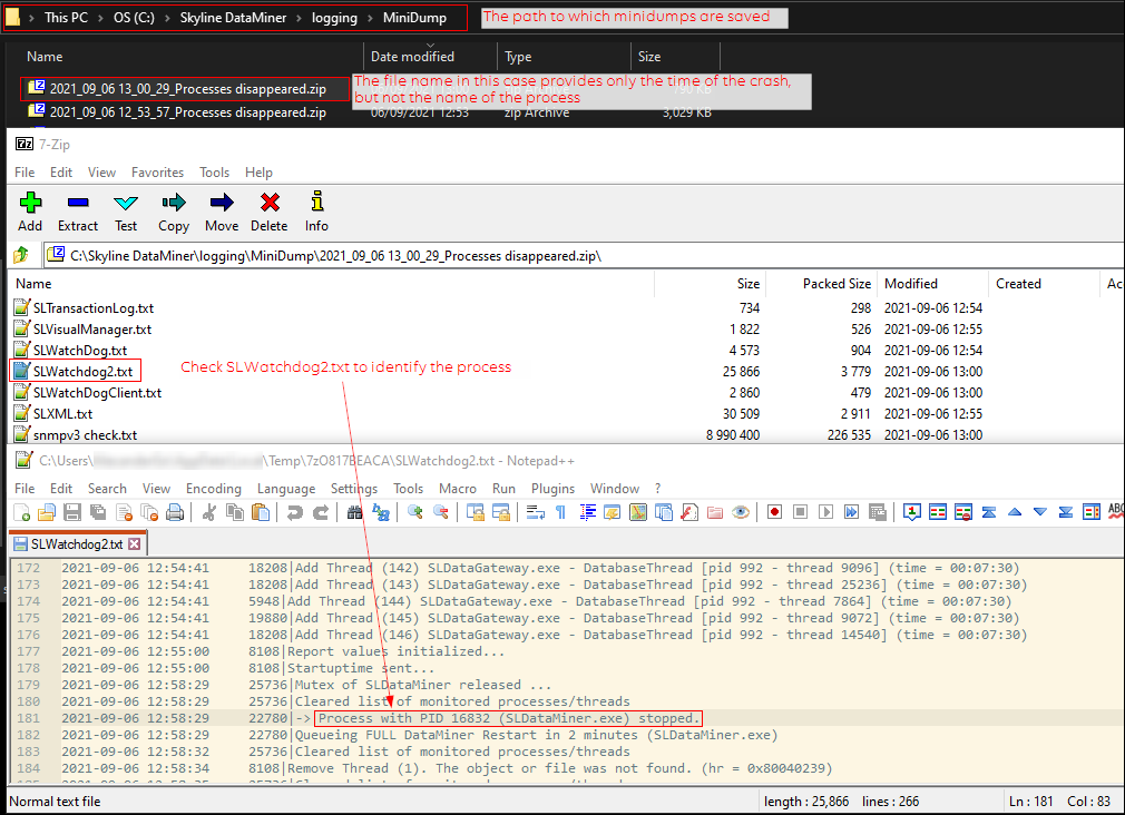

Also check if new files are present in C:\Skyline DataMiner\logging\MiniDump. Files are created in this folder when a process disappearance or a runtime error is detected by the SLWatchDog process.
The minidump is a copy of all DataMiner log files saved at the moment a problem is detected by SLWatchDog. It should not be confused with a crash dump and a memory dump, which are snapshots of memory allocated by a certain process.
  • In case of a runtime error, the file name format is <timestamp>_<process name>.zip. Note the name of the process and proceed to the next step.
  • In case of a process disappearance, the file name format is <timestamp>_Process disappeared.zip. You can find the name of the process in SLWatchdog2.txt inside the archive.
Example of minidump in case of process disappearance:
Where to start: minidumps
Check SLWatchdog2.txt for the initial problem

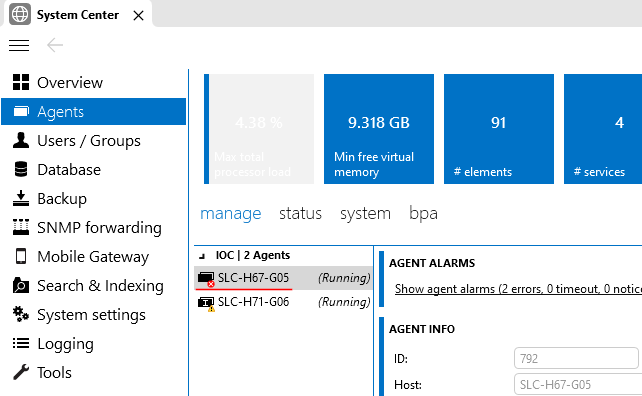

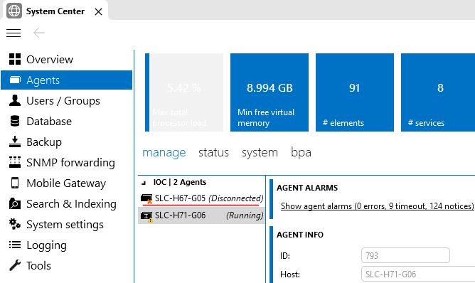

  • In System Center, go to the Agents tab, and check for DataMiner Agents with RTE or Timeout icons:
    RTE
    Disconnected
    System Center in DataMiner 10.6.4

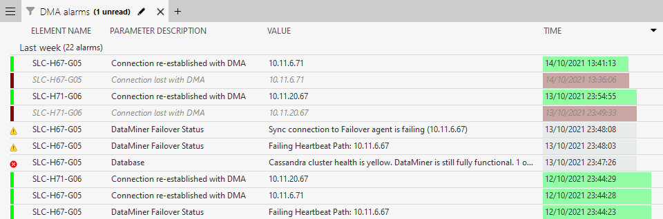

  • In the Alarm Console, add a filtered tab using the filter “Element type / Equal to / DataMiner Agent” to display DataMiner-related alarms.
    In the example below, the displayed alarms can point to an issue on a specific Agent:
    Alarm Console

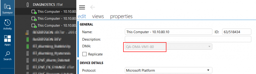

  • If a problem is related to a specific element or service, right-click and edit the object to see the hosting DMA of that object (indicated in the red box below):
    Hosting DMA
