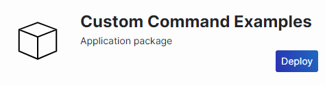

  1. Look up the Custom Command Examples package in the Catalog.
    Custom Command Examples page in Catalog
  2. Click Deploy, and select the target DMS.

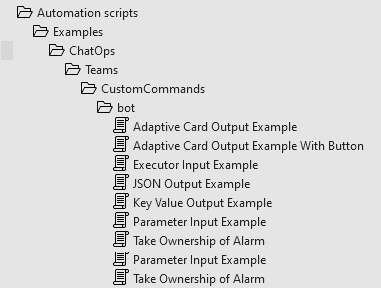

  3. Verify that the package has been installed correctly by accessing the scripts in the Automation module in DataMiner Cube.
    You should see the scripts illustrated below:
    Custom Command Examples scripts
    Take Ownership of Alarm CustomCommand Example script

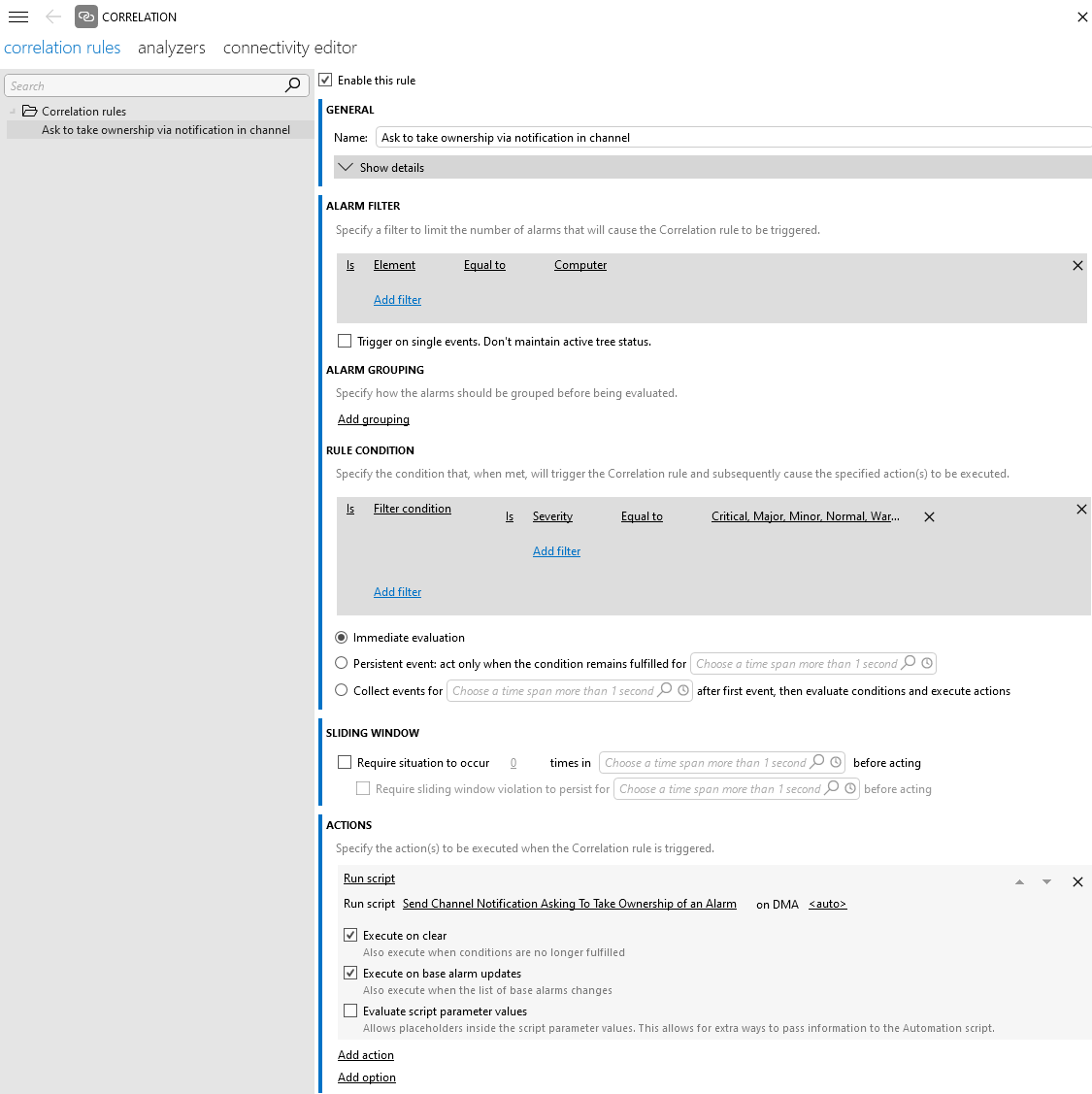

In this step, you will adjust the correlation rule from the Chat notifications tutorial so that it sends a channel notification with custom buttons in an Adaptive Card when it is triggered by a specific alarm.
  1. In DataMiner Cube, open the Correlation module.
  2. Select the correlation rule you created during the Chat notifications tutorial.

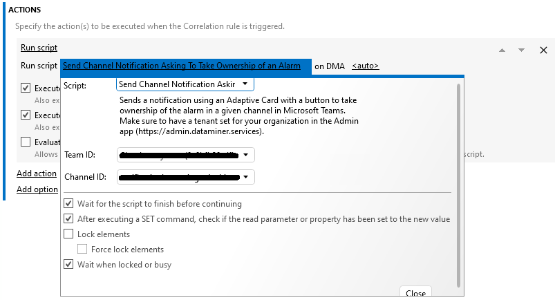

  3. In the Run script action of the rule, select the script Send Channel Notification Asking To Take Ownership of an Alarm instead, and specify the team and channel from step 3 as input.
    Configure the correlation rule
    Configure the correlation rule with the Send Channel Notification Asking To Take Ownership of an Alarm script

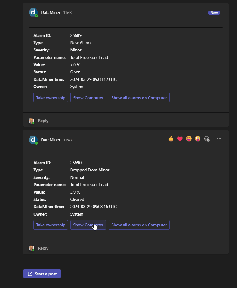

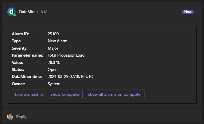

  4. Trigger an alarm that will trigger the correlation rule.
  5. Go to the Microsoft Teams channel you specified, and check whether the notification is displayed.
    For example:
    The Send Channel Notification Asking To Take Ownership of an Alarm notification received in the channel
Step 5: Use the custom buttons from the notification
The notification in the channel contains a few buttons. Give them a try:

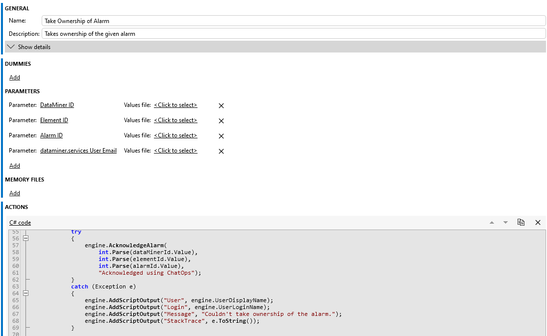

  • Take ownership: Executes the custom Take Ownership of Alarm command from the Custom Command Examples package.
    With such commands, you can easily interact with the notification. The response of the custom command can again contain an adaptive card with buttons. This enables you to create user flows, while a notification can still be sent in another channel or private chat. This functionality offers a multitude of possibilities.
  • Show [element name]: Makes the DataMiner bot show more information about the element in question.
  • Show all alarms on [element name]: Makes the DataMiner bot show any alarms associated with the element in question.
Use the custom button of the Adaptive Card and Take Ownership of the alarm as an example
