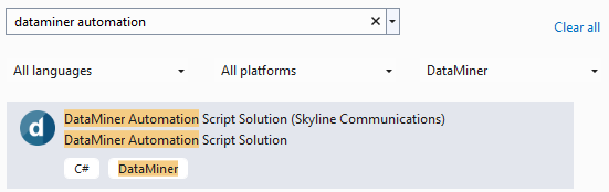

  2. In the template search box, search for DataMiner Automation Script Solution (Skyline Communications) and click Next.
    DataMiner Automation Script Solution in Visual Studio

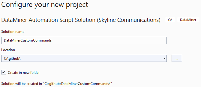

  3. Use DataMinerCustomCommands as the name for your solution, so you can reuse this solution for any future custom command scripts.
    Visual Studio configure your project
  4. Choose a location to save the automation script solution and click Next.

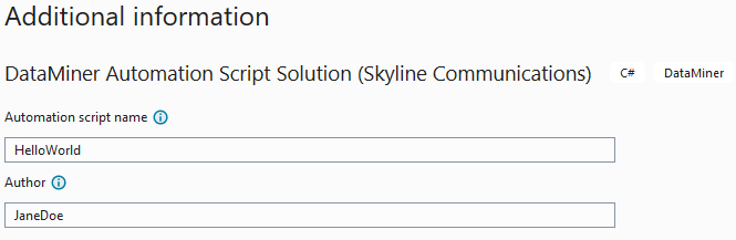

  5. Specify HelloWorld as the name of your automation script, fill in your name as the author, and click Create.
    Visual Studio create automation script

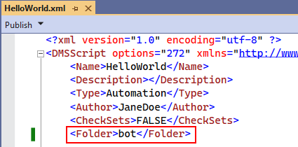

  1. For the bot to find your script, you need to place it in the bot folder:
    1. Locate the HelloWorld.xml file in the Solution Explorer and open it.
      HelloWorld.xml file in Solution Explorer
    2. In the Folder tag, specify bot and save the file.
      HelloWorld.xml file in editor

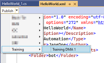

  2. At the top of the code window, click the arrow next to the Publish button and select the DataMiner System you want to upload the script to.
    Publish to DMA

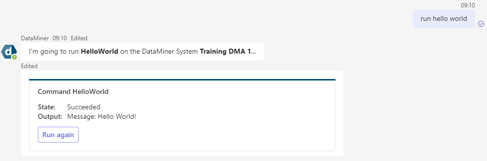

  1. Start a conversation with the Teams bot.
  2. Run the Hello World custom command.
