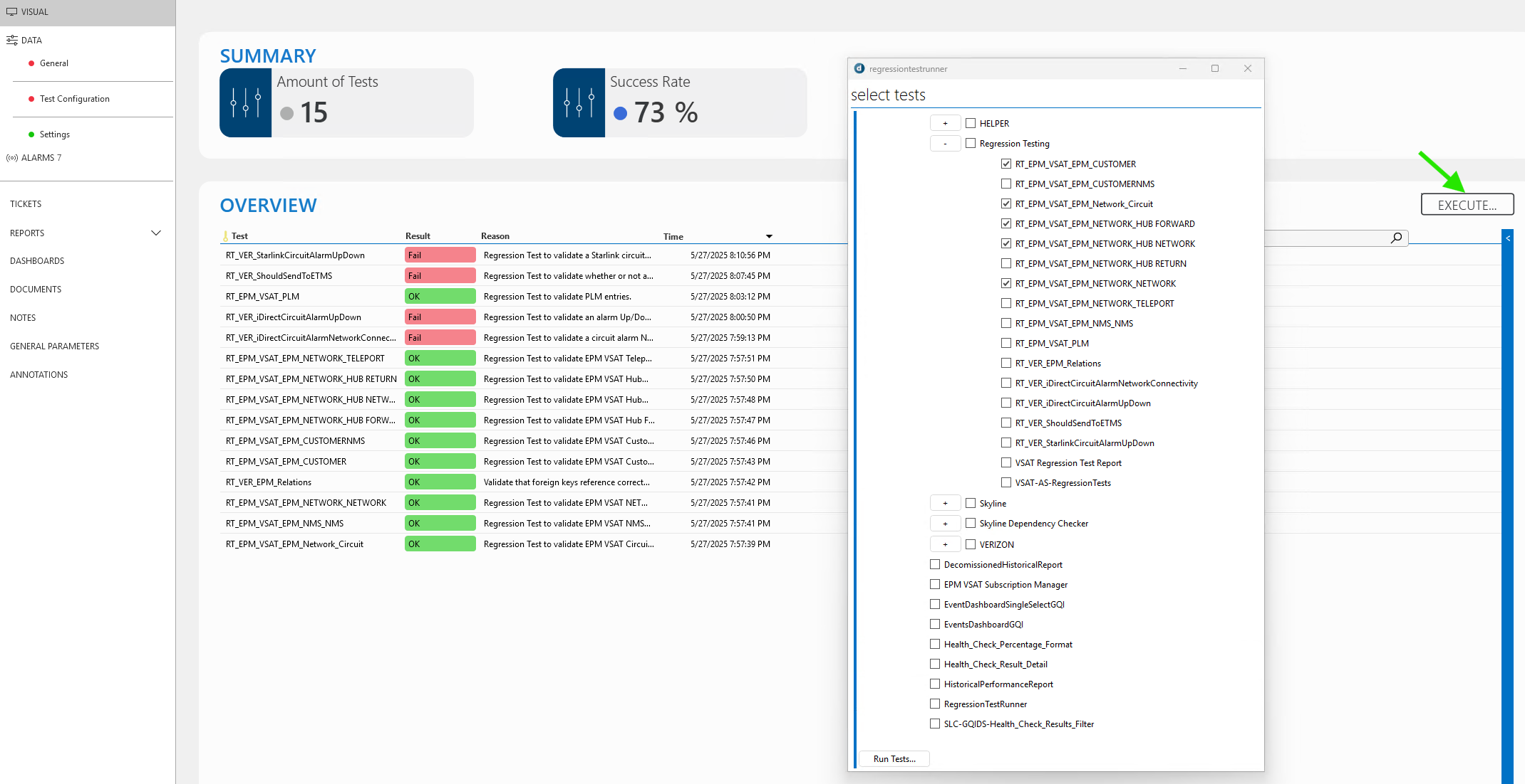

From the visual overview
On the visual overview of the Regression Test Results element, click the EXECUTE button. This will open a window where you can select specific tests or folders to run.
Visual overview

Viewing test results
Go to the General page of the Regression Test Results element to view the summary of test executions.
  • Summary shows the total number of tests and the overall success rate.
  • Overview displays the list of executed tests with their result, reason, and timestamp.

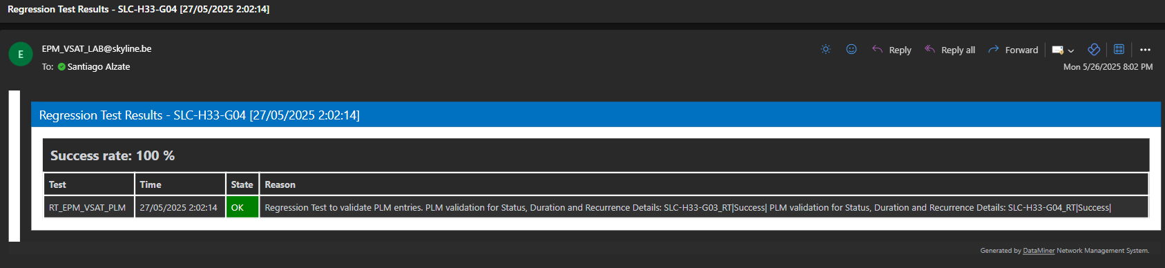

Email reports
If this is enabled on the Settings page, the system sends out a formatted email report after execution, with the following information:
  • Success rate
  • Test names
  • Result (OK/Fail)
  • Reason for failure or success
  • Timestamp
Email settings panel
These reports help quickly identify failures and track regression test health over time.
You can adjust email recipients or disable email entirely via the Settings page of the element.
