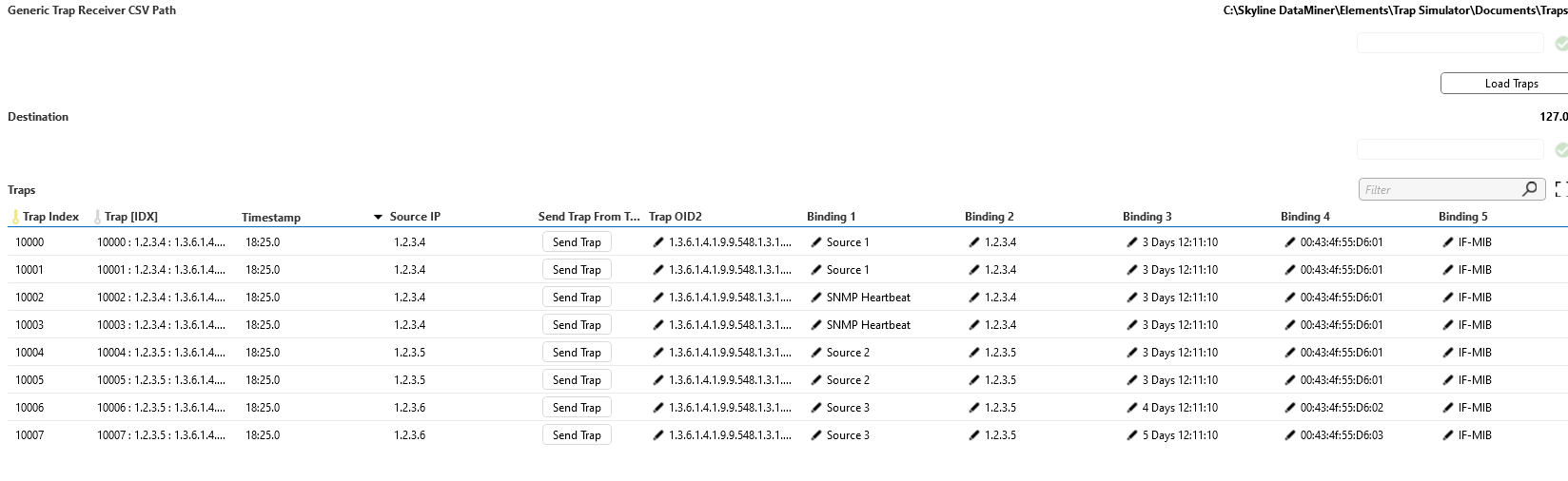

Step 6: Send traps via the trap simulator
  1. In DataMiner Cube, go to the Trap Simulator element.
    On the element card, you will see 8 different traps that have been pre-configured for the purpose of this tutorial.
    Trap Processor Simulator

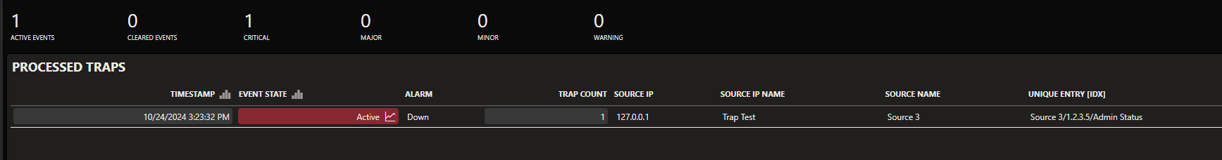

  2. In the first row, click Send Trap.
    This will send a trap with the matching configuration you have created in the Rules Table, allowing it to land in the Processed Messages Table. The trap will also match the trap OID you set for Raw OID Set, so it will get the event state Active.
  3. In the Smart Trap Processor app, go to the Processed Traps page and check the Processed Traps table.
    You will see that the Alarm, Source IP, Source IP Name, Source Name, and Unique Entry parameters all match the settings you configured earlier.
  4. Back in the Trap Simulator element in DataMiner Cube, click the Send Trap button in the second row.
    This will send a trap with the trap OID you configured for RAW OID Clear, so it will update the same row and classify the trap as Cleared.
  5. In the Smart Trap Processor app, check the Processed Traps table again.
    You will see that the Event State is now Cleared and that the Trap Count has increased for this specific row.
