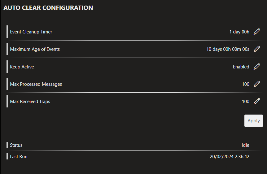

Auto-Clear Configuration
In the auto-clear section, you can configure parameters that will determine the maximum number of rows and the maximum time that traps will remain in the Processed Traps table.
Event Cleanup Timer: The interval at which the cleanup logic runs for the event tables.
Maximum Age of Events: The maximum age of events before these are removed from the tables. The timespan entered is compared to the latest timestamp of each row in the event tables to determine if a row should be removed.
Keep Active: If you enable this option, rows that have the event state “Active” will never be removed from the event table regardless of how old the active trap is.
Max Processed Messages: The maximum number of entries to keep in the Processed Traps table.
Max Received Traps: The maximum number of entries to keep in the Received Traps table.
