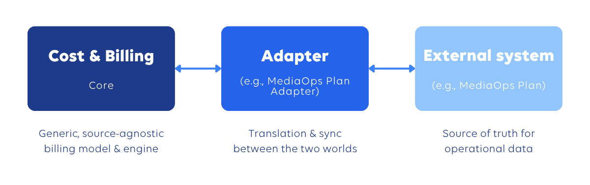

External integration architecture
The external integration architecture of the solution is built around three clearly separated layers:
| Layer | Role |
| Cost & Billing | The core module. It owns the generic domain model (items, groups, billable events, contracts, and rate cards). It is completely source-agnostic, i.e., it contains no references to any external system. This component always has to be installed, regardless of the external system being integrated. |
| Adapter | The component responsible for fetching data from the external system and mapping it to the Cost & Billing domain objects (e.g., resources → items, jobs → billable events). The adapter is the only component that knows about both worlds. |
| External system | The external operations platform (MediaOps Plan or any equivalent solution). It acts as the source of truth for operational data that must be reflected in Cost & Billing. It is accessed exclusively through the adapter. |
The Cost & Billing core never communicates directly with an external system, and external systems never touch Cost & Billing internals. All translation happens in the adapter.
For more details on the external integration, refer to Integration with other solutions.

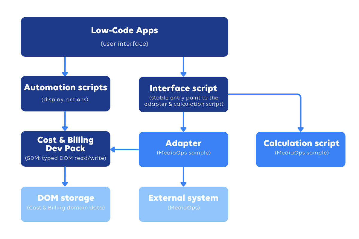

Solution components
This is the full component stack of the solution:
| Component | Description and role |
| Low-code app | The user-facing DataMiner interface. This is where users manage contracts and rate cards, browse the synced items and billable events, and calculate the cost and billing of those billable events. |
| Interface script | A dedicated automation script that acts as the communication layer between the low-code app and whichever adapter is deployed. The low-code app always calls this script; the script calls the correct adapter. This decouples the low-code app from adapter-specific implementation, which means that swapping or adding adapters requires no changes to the low-code app. |
| Automation scripts | The solution contains a series of DataMiner automation scripts (ad hoc, interactive, and basic automation). These are mainly used through the low-code app to retrieve data, handle user interactions such as creating or saving data, and perform logic. |
| Cost & Billing Dev Pack | A reusable package containing the SDM (Standard Data Model): the DOM interaction layer that provides typed read/write access to the Cost & Billing DOM instances (rate cards, contracts, items, billable events, etc.). |
| Adapter | The system-specific component (e.g., the MediaOps Plan Adapter). Fetches external data and maps it to Cost & Billing domain objects. |
| External system | The external operations platform, which serves as the source of truth for operational data. Accessed only through the adapter. |
