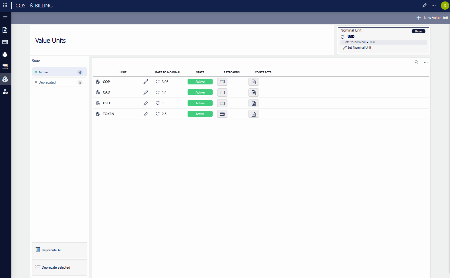

  1. On the Value Units page, click Set Nominal Unit.
  2. In the pop-up window, select the nominal unit in the drop-down menu, and click Save.

  1. In the upper-right corner of the Value Units page, click + New Value Unit.
  2. In the pop-up window, configure the following settings:
    • Unit: The name of the value unit.
    • Rate to Nominal: The exchange rate from this unit to the nominal value unit: X Value Unit = 1 Nominal Value Unit.
    The State field is by default set to Active when a value unit is created.
  3. Click Save.
All value unit conversion rates are shown on the Value Units page.

You can edit each of the value units in the app using the pencil icons in the Value Units table.
A value unit can also be deprecated, in which case it can no longer be used when new contracts or rate cards are created or when calculations are performed.
To deprecate a single value unit, edit the unit and select Deprecated in the State box.
To deprecate value units in bulk, use the Deprecate All or Deprecate Selected buttons.
