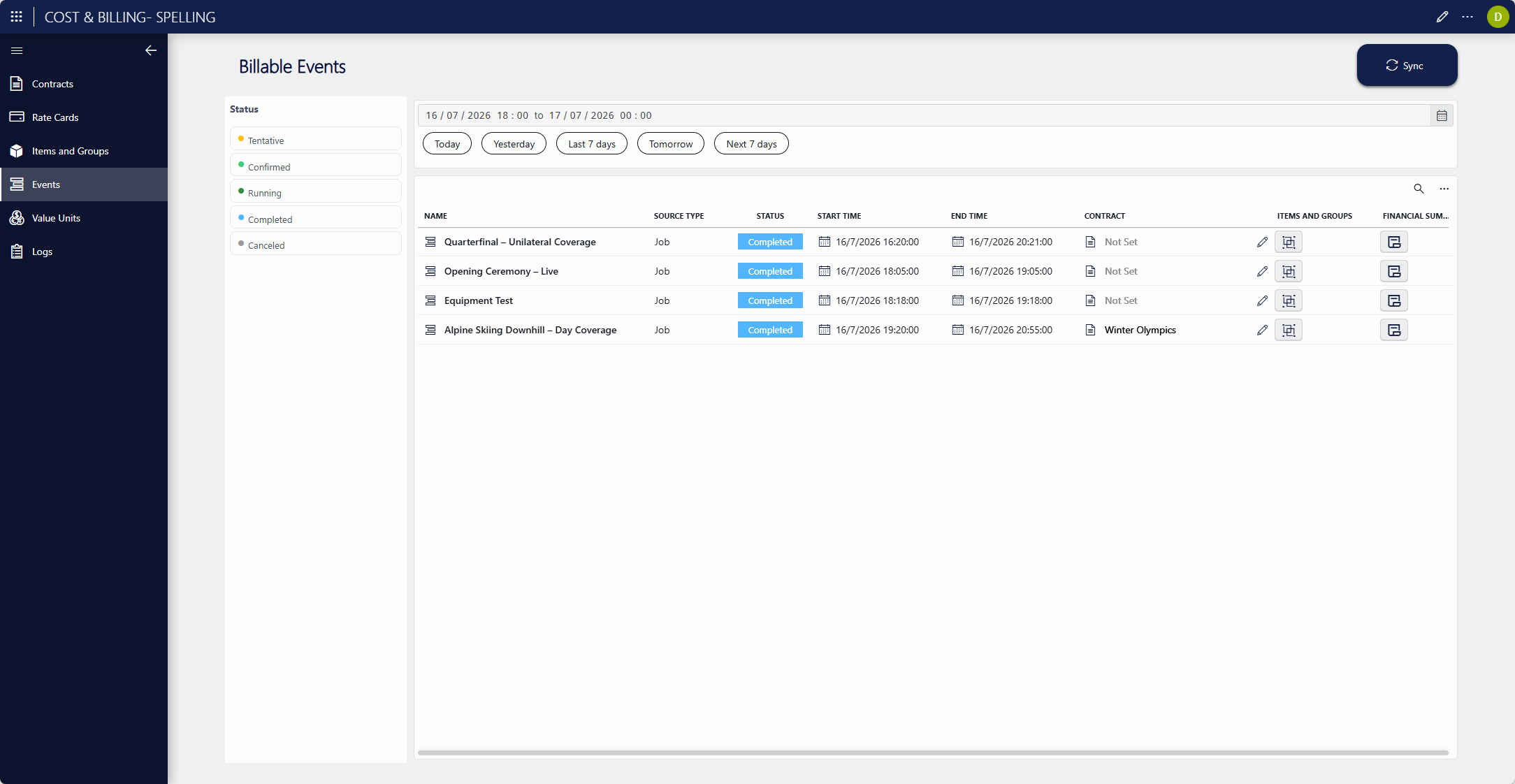

On the Billable Events page, you can manage all billable events brought in from the external solution. If the MediaOps Plan sample integration is used, the billable events are the jobs.
For each billable event, you can:
  • View the linked items and groups involved in the event.
  • Perform the cost and billing calculation, at any stage of the billable event.
Cost & Billing billable events
Syncing billable events
With the Sync button on the Billable Events page, you can retrieve all billable events from the integrated external solution.
If Cost & Billing is integrated with MediaOps Plan, this sync must be performed at least every 24 hours. This must be scheduled via DataMiner Scheduler.
This is necessary because on initial installation, the MediaOps Plan Adapter retrieves every available billable event. After that, each sync retrieves the billable events starting from the past 24 hours. If more than 24 hours pass without a sync, changes that happened before that window will not be reflected in Cost & Billing.

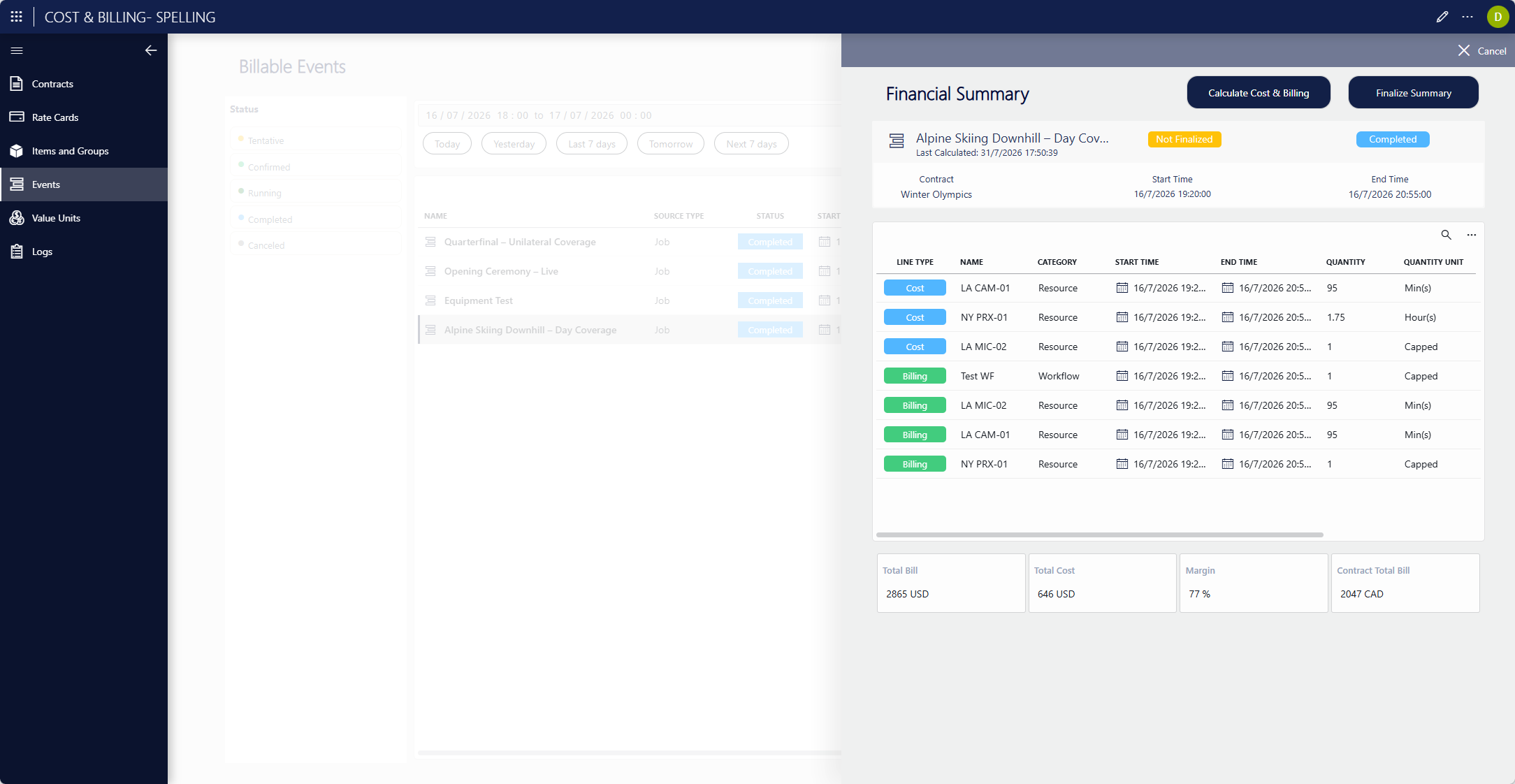

Calculating the cost and billing for billable events
To calculate the cost and billing of a billable event:
  1. Make sure the event has a contract assigned.
  2. In the Billable Events table, click the corresponding Financial Summary button.
    This will open the Financial Summary panel.
  3. In the panel, click the Calculate Cost & Billing button at the top.
    The details of the cost and billing will be displayed.

Finalizing a billable event
After a calculation, at any point, you can mark a billable event as finalized using the Finalize Summary button in the calculation panel. This freezes the calculated results, so that the billable event can no longer be recalculated.
This can for example be useful when a rate card configuration or a contract condition changes afterwards: freezing the result guarantees that such changes will not affect it.
Note that this action is irreversible: once a billable event is finalized, it cannot be unfrozen or recalculated, and there is no way back.
As long as it has not been finalized, a billable event can be calculated as many times as needed.
