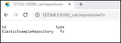

  5. Verify whether the repository has been created correctly by entering http://[IP address]:9200/_cat/repositories?v in your browser's address bar or in your chosen client application. Replace "[IP address]" with your IP address.
    If the repository was created correctly, the name of your repository should be visible on the page or in the client.

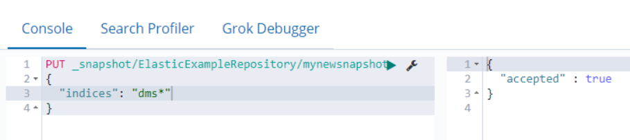

  1. Execute the PUT request http://[IP address]:9200/_snapshot/repositoryname/snapshotname {“indices”: “dataminerprefix*”} in your chosen client application.
    Example, using Kibana as client application:
    Example Kibana
    • "[IP address]": Your IP address.
    • "repositoryname": The repository name you chose while preparing the source Elasticsearch cluster.
    • "snapshotname": The name of the chosen backup.
    • "dataminerprefix": The prefix DataMiner puts in front of an index name.
    To find the prefix DataMiner puts in front of an index name, enter http://[IP address]:9200/_cat/indices in your browser's address bar. Replace "[IP address]" with your IP address.
    Take note of the prefixes used in the indices. The default prefix is "dms".

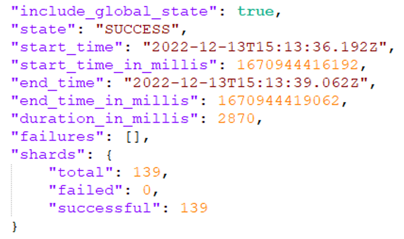

  2. Verify that the snapshot was created successfully by entering the GET request http://[IP address]:9200/_snapshot/repositoryname/snapshotnamein your browser's address bar or in your client application.
    The field next to "state": should display "SUCCESS".
    State success
