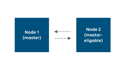

Let us assume that we have a situation like the one depicted below: 2 nodes, both eligible to become master, of which one is currently acting as master node.

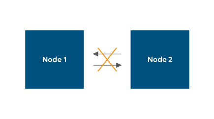

At some point, while both nodes are busy synchronizing, reading data and writing data, network connections are lost.

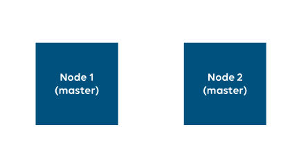

As they can no longer detect each other, both nodes will assume the other one is offline and, as a result, they will both promote themselves to master node. In essence, there will now be 2 clusters with a single master node each.
This is a so-called split-brain situation. Both single-node clusters will now each receive requests to read and write the same data.

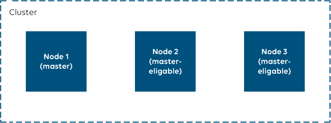

Let us assume we have a 3-node cluster and that all three nodes are eligible to become master ("node.master:true") ...

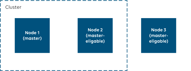

... and that node 3 is either offline or no longer connected to the other nodes due to a network issue ...
At this point, node 3 could decide to become a separate cluster.
However, by setting discovery.zen.minimum_master_nodes to 2 in the elasticsearch.yml files of the three nodes, this will not happen. This setting defines how many potential master nodes must be online before a cluster is formed. If it is set to 2, then node 1 and 2 will each notice that there are still 2 potential master nodes online in the cluster. A master node election procedure will then promote one of the two nodes to master node and a new functional 2-node cluster will be up and running. Node 3 will not find any node that is eligible to become master. Hence, it will not create its own cluster and will not accept requests to read or write data.
