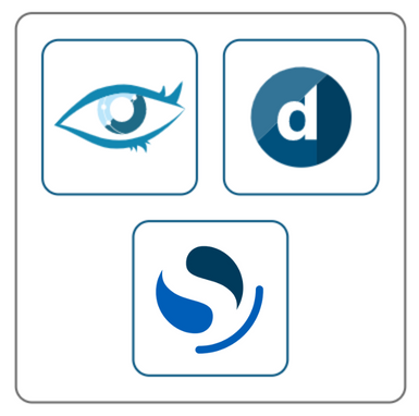

Development setup: DataMiner, Cassandra, and OpenSearch hosted on the same machine

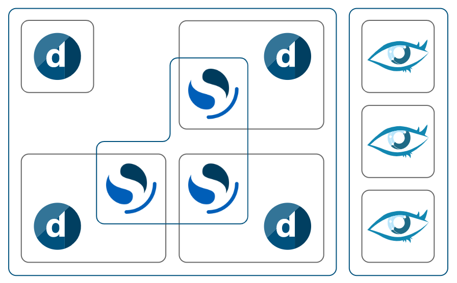

Multiple DMA (non-Failover) setups
In case you have more than one DataMiner Agent, you can scale both on DataMiner level and on database level. If you want to use cloud storage instead, we recommend switching to Storage as a Service (STaaS). Setups with Amazon Keyspaces Service, Azure Managed Instance for Apache Cassandra Service, and Amazon OpenSearch Service are considered deprecated as of DataMiner 10.3.0 [CU9]/10.3.12.
An on-premises OpenSearch cluster must have an uneven number of nodes, running on Linux machines. This means that if you want to leverage replication or have a redundant system, you need at least 3 nodes.
Instead of OpenSearch, you can also use Elasticsearch. However, Elasticsearch is only supported up to version 6.8, so this is not recommended. It is also possible to host a DataMiner and Elasticsearch node on the same machine. In this case, Elasticsearch and DataMiner must be installed on a separate disk or partition. Note that in that case it is not required to install an Elasticsearch node on every single DataMiner node. While compute resources can be shared, logically there still is a separate DataMiner node cluster and Elasticsearch cluster.
For Cassandra, any number of nodes can be used, running on Linux machines. To get an idea of how many nodes would be required for your system, use the node calculator.

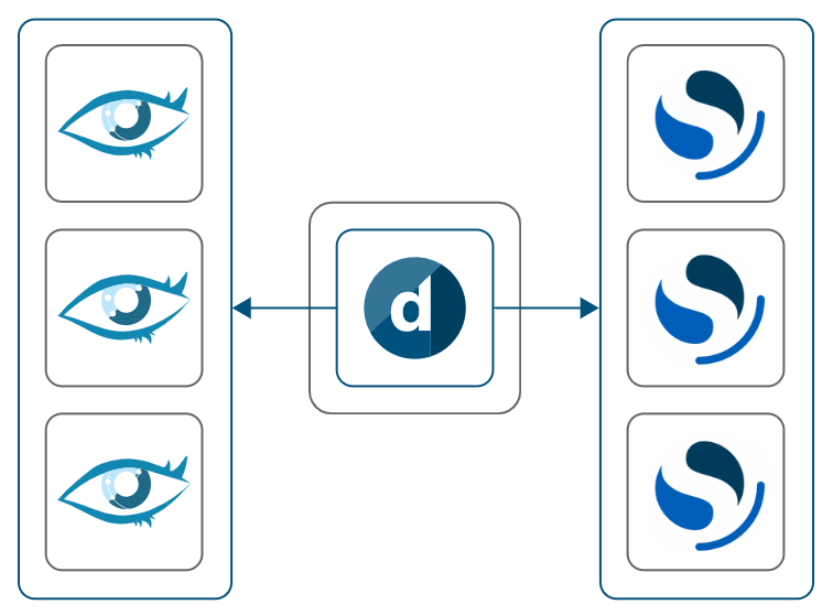

Recommended on-premises setup: DataMiner, Cassandra, and OpenSearch hosted on dedicated machines, with a minimum of three OpenSearch nodes
Setup with OpenSearch and DataMiner sharing resources

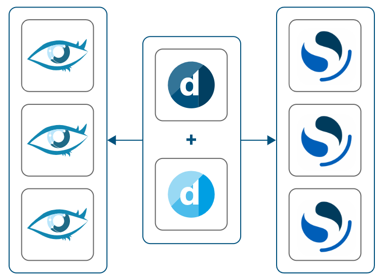

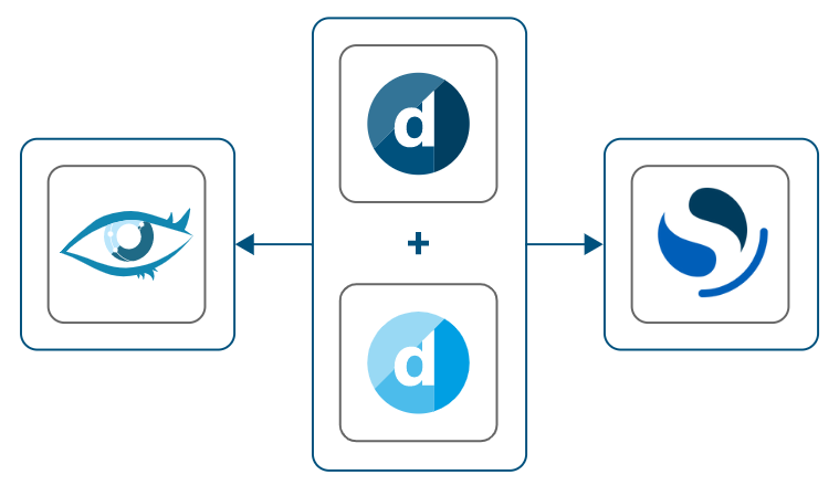

Failover setups (without geo-redundancy)
A Failover setup is similar to the previously mentioned setups. You can consider the Failover pair to be like one DMA in the DMS. This setup should at the very least consist of two DataMiner machines, one OpenSearch or Elasticsearch machine, and one Cassandra machine. However, if the Cassandra or OpenSearch/Elasticsearch machine are no longer available in this setup, you will no longer be able to start DataMiner, so this is not recommended for redundancy setups. Also, as Elasticsearch is only supported up to version 6.8, using Elasticsearch is not recommended.
To be fully hardware-redundant, we recommend at least three machines hosting OpenSearch nodes, two machines hosting the DataMiner Failover pair and three machines hosting Cassandra nodes. More Cassandra and OpenSearch nodes can be needed depending on the load on your system. Check the node calculator for more information.
While hosting Elasticsearch and DataMiner nodes on the same machine is already not recommended in general, this should definitely not be done in a Failover setup, as it will not allow you to get the desired resilience.

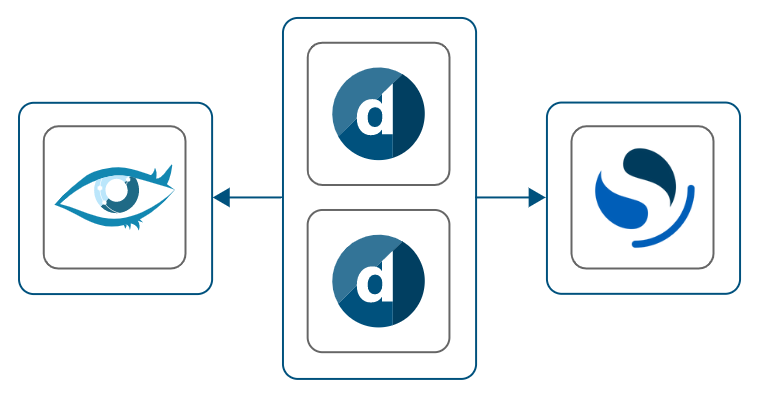

DataMiner Failover pair using a Cassandra and OpenSearch database running on dedicated machines

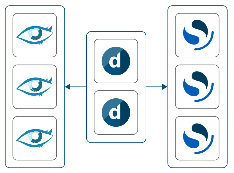

Minimum recommended on-premises setup for a fully redundant system

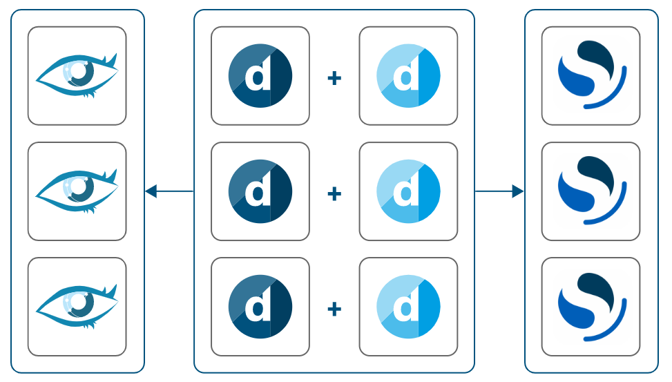

DataMiner System consisting of three Failover pairs with Cassandra and OpenSearch nodes running on dedicated machines

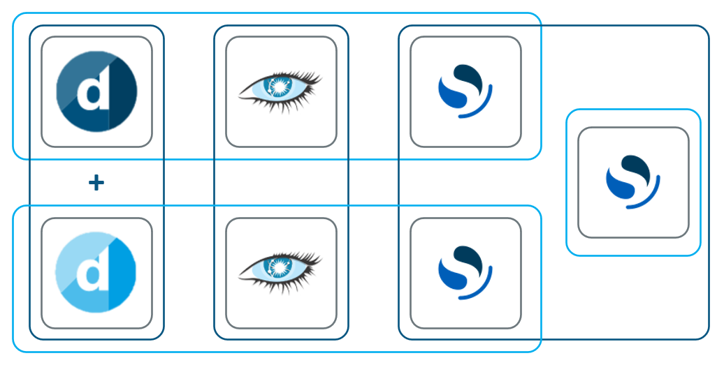

The figure below illustrates the recommended minimum setup for geo-redundancy with on-premises machines. For Cassandra, the built-in NetworkTopologyStrategy is used to configure geo-redundancy. For OpenSearch, one cluster is configured for which the nodes are spread over three zones, two of which host the data, while the third zone has a single node that does not handle any data and functions as a tie-breaker for cluster configuration. The tie-breaker node can be cloud-hosted if the latency is sufficiently low (below 50 ms). To ensure that OpenSearch understands which node is a data node on which location, shard allocation awareness must be configured.
Recommended minimum setup for a geo-redundant system
