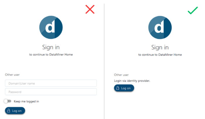

SAML authentication issues in Cube/online
You may encounter an issue where the expected redirection to the identity provider's login page does not occur when you try to log into your DMA via the web using external authentication through SAML. This issue can also manifest in Cube, where the SAML login window fails to appear.
If you are accessing your DMA via the web, check if the user credential boxes are visible during the login process. If they are visible, this suggests the external authentication is not in use.
If the external authentication is working properly, you will get the option to log in via identity provider.
DataMiner version 10.3.10
The password field is filled in
If the password field is already filled in, leave it empty. Local logon attempts take precedence over external authentication.

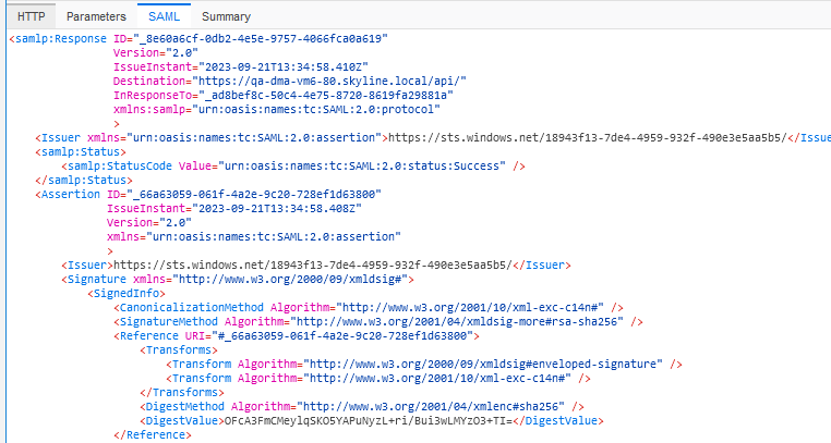

If issues persist, capture SAML traffic as specified under Collecting the SAML response
Compare the attribute names in the collected response with those in the identity provider and the DataMiner.xml file.

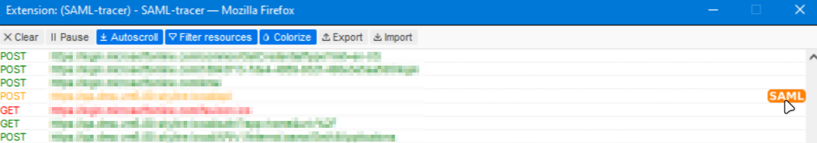

To collect the SAML response, use the SAML-tracer extension:
Add the SAML-tracer extension to your chosen web browser:
For Google Chrome, visit the Chrome Web Store.
For Firefox, visit the Firefox Add-ons page.
Go to
http(s)://[DMA name]/.Click the puzzle icon in the upper-right corner of your browser and select SAML-tracer from the list of available extensions.
Click any received SAML response marked with an orange bubble labeled "SAML".
In the pane at the bottom, select SAML.
