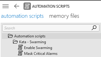

  3. When the package has been deployed, open DataMiner Cube and check whether you can see the following scripts in the Kata - Swarming folder of the Automation module:
    • Mask Critical Alarms: This is a demo script to mask the critical alarms of an element.
    • Enable Swarming: This interactive automation script takes you through the enabling procedure for Swarming.

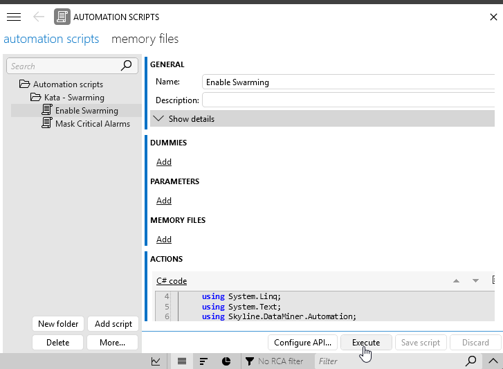

  1. In the Automation module in DataMiner Cube, select the Enable Swarming script and click the Execute button.
    Execute the Enable Swarming script
  2. In the pop-up window, click Execute now.

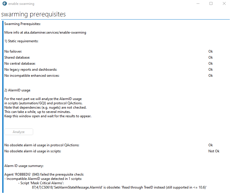

    Information about the Swarming prerequisites will be displayed.
  3. Take a look at the mentioned static requirements.
    These are the DMS requirements that are more difficult to change, such as the database type or Failover configuration. Based on the prerequisites for this tutorial, all prerequisites should be met, except possibly the requirement for compatible enhanced services.

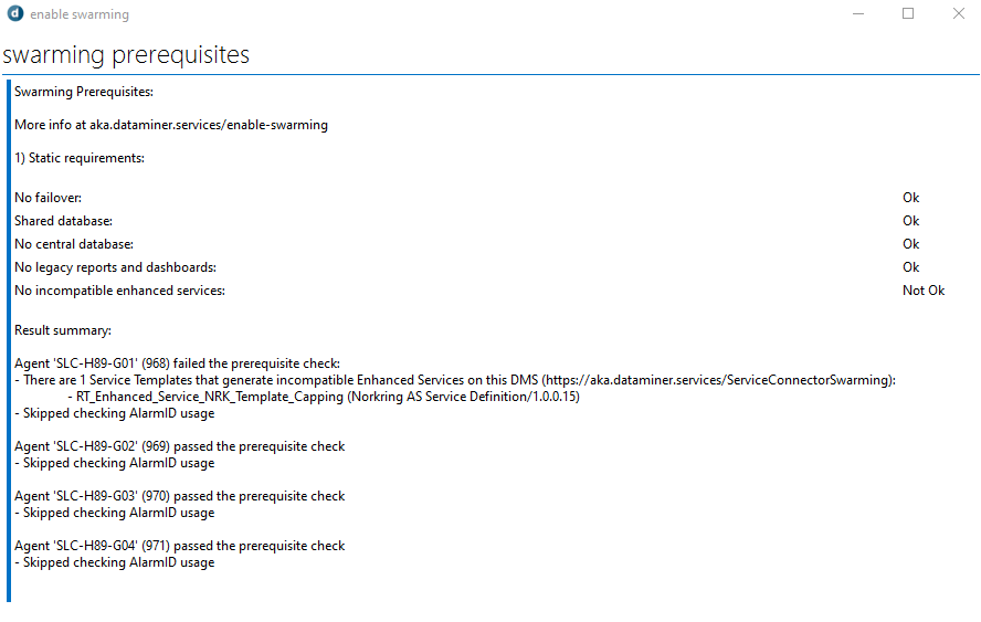

  4. In case No incompatible enhanced services is Not Ok:
    1. Check in the Catalog if a more recent version of the enhanced service connectors is available and upgrade to the latest version if possible.
    2. If upgrading to a more recent version is not possible, follow the instructions to prepare enhanced service connectors for Swarming
    3. Run the Enable Swarming script again.

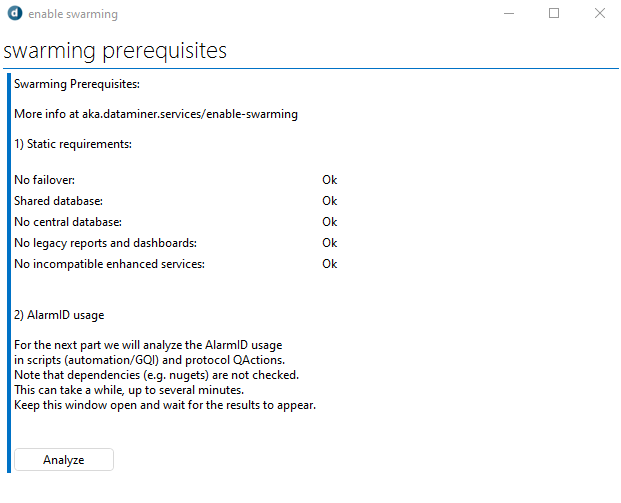

  5. Click the Analyze button to start checking the alarm ID usage.
    This button will only be available once all static requirements are met. It will analyze the use of the unique identifiers of alarms in scripting (automation scripts and QActions), as this has been modified to support Swarming. (See About the alarm ID changes.)
    This check can take up to several minutes, depending on the number of scripts and connectors in the system.
    Alarm ID usage
    It is not possible to scan dependencies (e.g., NuGets) with this script, so these may still contain outdated references. However, if this should be the case, running these scripts on a system where Swarming is enabled will throw a clear error message.
  6. Take a look at the results of the analysis.
    Alarm ID usage problem

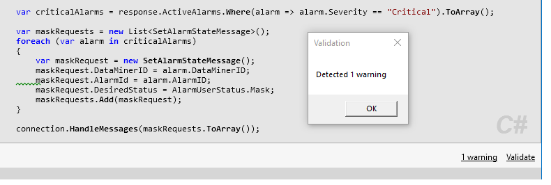

    The Mask Critical Alarms script will be displayed as one of the problems that have been found. This script takes as input a reference to an element and will mask all critical alarms of this element. It does so by using a SetAlarmStateMessage and includes an identifier reference to the alarm it should mask, but this identifier still uses the old style of referring to an alarm, i.e., a DataMiner ID/alarm ID integer combination. This is must be changed to a tree ID instead.
  7. Open the Mask Critical Alarms script in the Automation app, scroll down, and click Validate to check for errors and warnings.
    You will see that a warning is detected.
    AlarmID Usage Problem Warning
    Note that you could also open the script via DIS in Visual Studio instead, if you have this installed. In that case, if you target the Skyline.DataMiner.Dev.Automation package version 10.5.1 or higher, you will also see an obsolete warning for this script.
  8. Update the code in the foreach block (line 85) as follows:

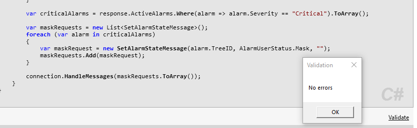

       var maskRequest = new SetAlarmStateMessage(alarm.TreeID, AlarmUserStatus.Mask, "");
       maskRequests.Add(maskRequest);
  9. Click Validate again to see if all warnings and errors are gone.
    Alarm ID usage problem fix
  10. Click Execute to run the script and test if it still works correctly.

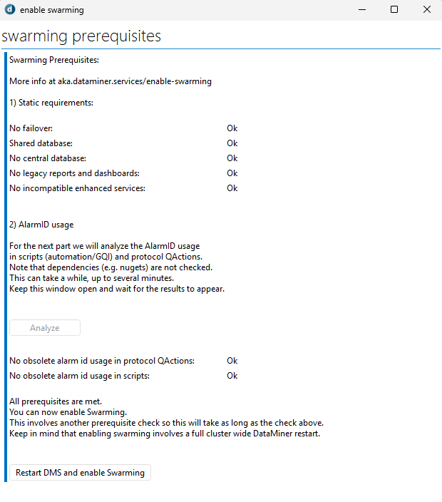

  12. Run the Enable Swarming script again and click the Analyze button again.
    If you have indeed correctly updated all scripts and protocols, a new button will be displayed at the bottom of the window. If you do not see this button, check which scripts or protocols still need to be updated and adjust them as mentioned above.
    AlarmID Usage Problem Fix
  13. Click Restart DMS and enable Swarming.
    The script will now double-check the requirements (which will again take some time), enable Swarming, and restart DataMiner.

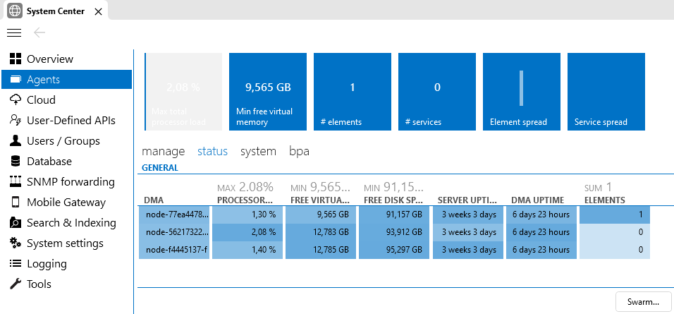

  1. Go to System Center > Agents > Status and click the Swarm button in the lower-right corner.
    If you see a Migrate button here instead, this means Swarming has not been successfully enabled.
