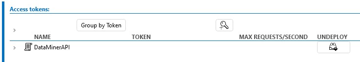

    Obsolete APIs in System Center in Cube on a 10.3.9 DataMiner
  3. To undeploy the API, click the button in the Undeploy column, and then click Yes.
When finished, you should only have Unused Tokens left in your tree view. This process only needs to be done on one DataMiner Agent in the cluster. The changes will be synchronized to the rest of the cluster.
