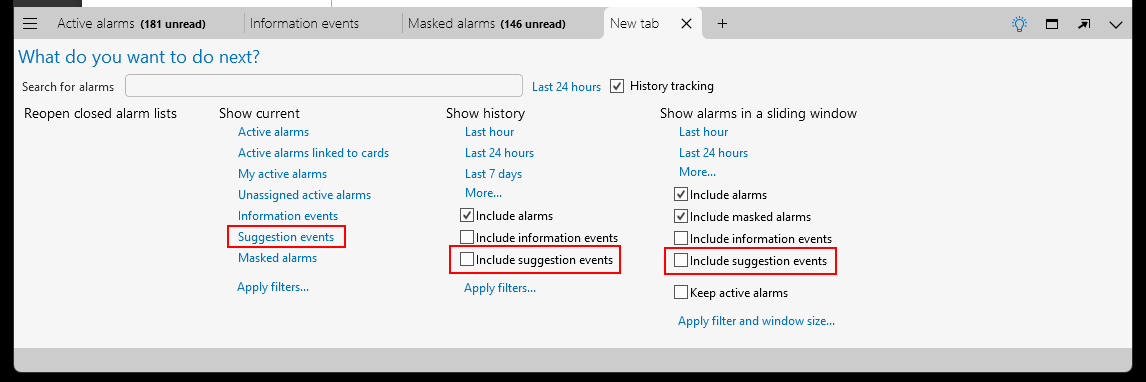

These suggestion events can be viewed in a dedicated suggestion events tab, as alarms with severity "Information" and source "Suggestion Engine". To see suggestion events in the Alarm Console, open a new tab and select to see suggestion events. This is possible for active alarms, history alarms, and alarms in a sliding window.
New alarm tab
New Alarm Console tab in DataMiner 10.6.5

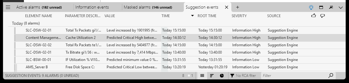

Here is an example of a suggestion events tab:
Suggestion events tab
Suggestion events tab in DataMiner 10.6.5
