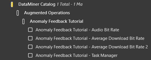

Step 1: Install the example package from the Catalog
  1. Go to https://catalog.dataminer.services/details/4d0fa49c-6355-42d5-943d-e747b6c62906.
    This will create several DataMiner elements in your system that will be used throughout the rest of this tutorial. The elements will be located in the view DataMiner Catalog > Augmented Operations > Anomaly Feedback Tutorial.

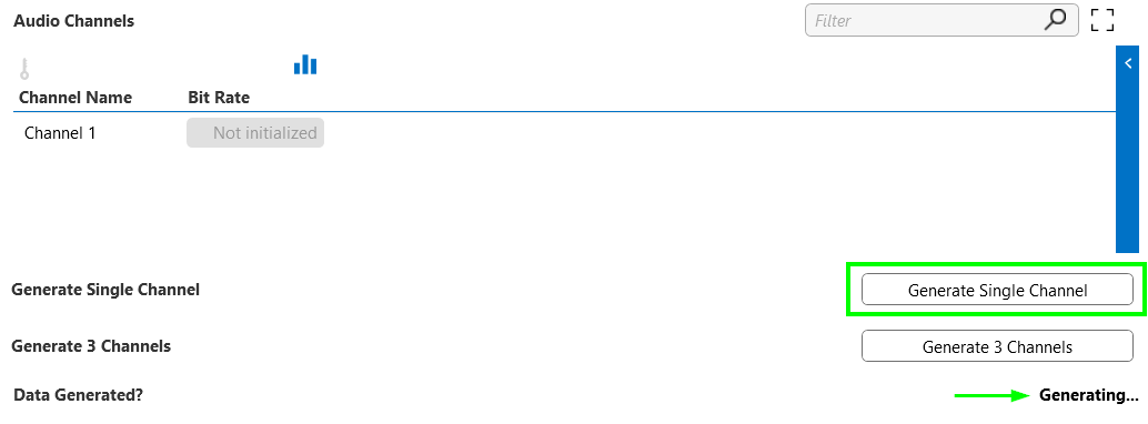

  2. Click the Generate Single Channel button.
    This will generate bit rate data for a single channel in the table Audio Channels above.
    Throughout this tutorial, when generating data, always wait until the Data Generated? parameter displays Yes before proceeding to the next step.

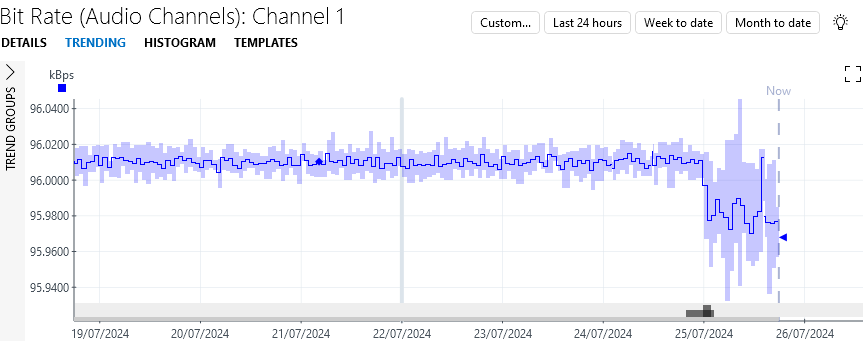

  3. Open the trend graph for the bit rate of the newly generated audio channel by clicking the trend icon next to the Channel 1 parameter in the Audio Channels table.
  4. Click Week to date to see the data for the past week.
    You will see that the bit rate remained very stable just above 96 kBps, then suddenly drops slightly and starts to fluctuate more. This behavior is typical when switching an audio bit rate parameter from Constant Bit Rate (CBR) encoding to either Average Bit Rate (ABR) or Variable Bit Rate (VBR) encoding. ABR and VBR allow greater, temporary deviations from the target bit rate. A drop or a jump at the moment of the switch, as you see here, is common but not guaranteed.
    Just below the bit rate drop, two dark gray blocks are displayed, indicating two detected changes in behavior, or change points. This means two anomalies were detected at that moment. If you hover the mouse over them, you will see that one is a variance change, corresponding to the parameter becoming less stable, and the other is a level shift, corresponding to the drop.
    Since the two anomalies occur around the same time, the labels that appear when you hover over the change points might overlap, causing one label to be hidden. To view both labels clearly, zoom in by pressing Ctrl while scrolling up. After zooming in, you can revert back by clicking the Week to date button again.
    Bit rate with drop and transition from stable signal to less stable signal

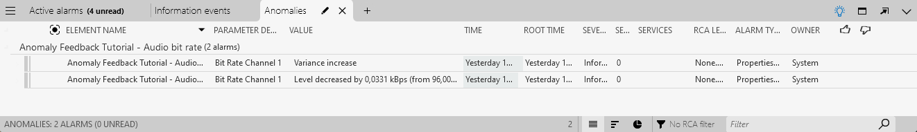

  6. Click the menu item 2 anomalies were found in your trend data (this can also be a higher number if your system has detected anomalies on other elements).
    A new Anomalies tab will now be shown in the Alarm Console, listing the two detected anomalies.
    In the Value column of the Alarm Console, similar to the trend graph, you will see that the detected level shift was very small: Level decreased by 0.0331 kBps (from 96.0089 kBps to 95.9758 kBps). This corresponds to a drop of approximately 0.003 kBps.
    The reason such a small drop was detected is that, although minor, it exceeds the variability of the parameter before the drop. However, a drop of this size is unlikely to be relevant to an operator. Therefore, you want to remove this anomaly, while still keeping the variance change to detect other instances of switching between CBR and VBR encoding.

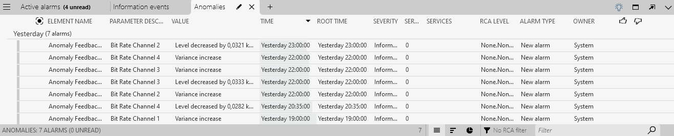

    2. Click the Generate 3 Channels button to generate three more audio channels with data similar to the first one, each with a variance change and a level shift anomaly.
    3. In the Alarm Console, give the level shifts detected for Bit Rate Channel 2, Bit Rate Channel 3, and Bit Rate Channel 4 negative feedback, and optionally clear them using the light bulb icon.
      Giving negative feedback to all three level shift anomalies

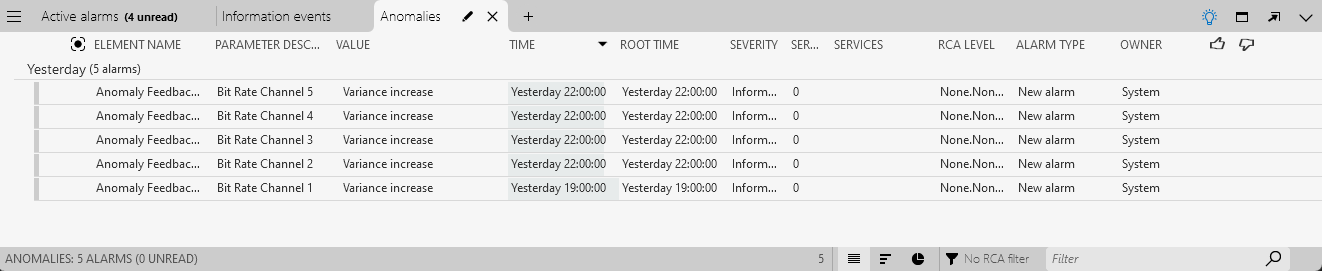

  10. On the DATA page of the Anomaly Feedback Tutorial - Audio Bit Rate element, generate an additional audio channel by pressing Generate Single Channel. For this channel, only a variance change is generated and no level shift because DataMiner's anomaly detection has learned from the previously submitted feedback that level shifts of this size are not interesting.
    Alarm Console with a variance change for Channel 5, but no level shift

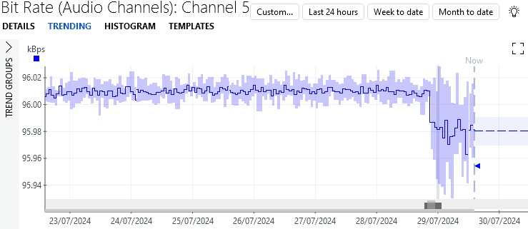

    Bit rate of Channel 5 with level shift as a change point, but not as an anomaly
    In the trend graph, you can see that a level shift was still detected. However, the change point below the bit rate drop is light gray this time, which indicates a lower level of importance, meaning it is not marked as an anomaly. So, while the change is still detected, it is no longer seen as unexpected by DataMiner.

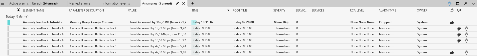

  1. Select the element Anomaly Feedback Tutorial - Average Download Bit Rate in the Surveyor.
    This element simulates parameters monitoring the average download bit rate in a terrestrial network for each sector (i.e., per town or neighborhood). This bit rate can fluctuate over time, depending on the level of traffic generated by connected households or companies. However, a significant sudden drop may indicate an outage.
  2. Click the Generate Data button to generate data for a network sector.

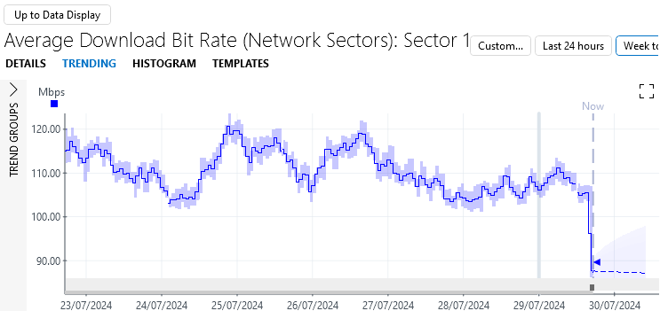

  3. Open the trend graph for the bit rate of the newly generated network sector channel by clicking the trend icon next to the Sector 1 parameter in the Network Sectors table.
    As expected, the download bit rate fluctuates significantly but gradually over the past week. However, in the last hour, the bit rate drops by 15 Mbps. This drop is detected as an anomaly. You can tell DataMiner detects this as anomaly because of:
    • The dark gray block displayed below the drop in the trend graph.
      Average download bit rate within Sector 1 with a drop at the end

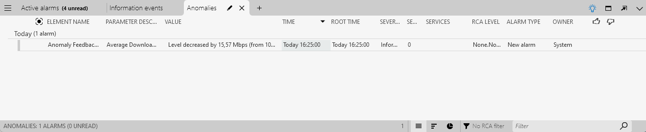

    • The level shift entry in the Anomalies tab of the Alarm Console.
      Anomalies tab in the Alarm Console with anomaly detected for Average Download Bit Rate of Sector 1
    While the drop is significant and caught by anomaly detection, 15 Mbps may not be large enough to cause concern in this context. Similar to the previous step, you want to prevent this anomaly from being flagged, but you still want to be notified of larger drops in the future.
  4. In the Anomalies tab of the Alarm Console, hover the mouse pointer over the level shift anomaly detected for the Average Download Bit Rate Sector 1 parameter and select the thumbs down icon in the Feedback column.
    This negative feedback will help the anomaly detection learn and make it less likely to trigger similar anomalies in the future. However, significantly larger drops will still be detected.

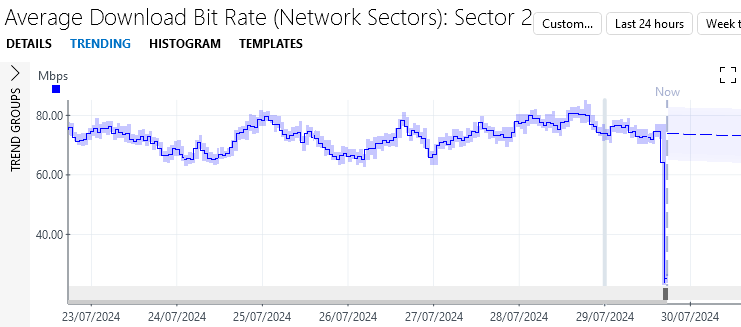

  5. On the DATA page of the Anomaly Feedback Tutorial - Average Download Bit Rate element, click the Generate Data button again to generate data for a new network sector.
  6. Open the trend graph for the bit rate of the newly generated network sector channel by clicking the trend icon next to the Sector 2 parameter in the Network Sectors table.
    The data looks similar, but this time a much larger drop of approximately 50 Mbps occurs at the end, which could indicate a network problem. You will want to be notified about such larger drops in the future.
    Average download bit rate within Sector 2

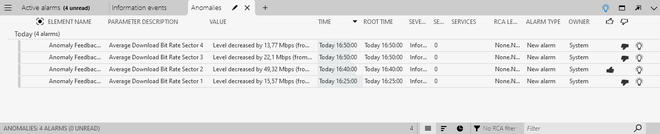

  7. In the Anomalies tab of the Alarm Console, hover the mouse pointer over the level shift anomaly detected for the Average Download Bit Rate Sector 2 parameter and select the thumbs up icon in the Feedback column.
    By providing different feedback for smaller and larger drops, DataMiner's anomaly detection will gradually learn which sizes of drops you want to be notified about.
  8. On the DATA page of the Anomaly Feedback Tutorial - Average Download Bit Rate element, click the Generate Data button twice to generate data for two more network sectors.
    Both network sector 3 and 4 experience only small drops in bit rate.
  9. In the Anomalies tab of the Alarm Console, hover the mouse pointer over the level shift anomaly detected for Average Download Bit Rate Sector 3 and Average Download Bit Rate Sector 4 and select the thumbs down icon in the Feedback column.
    Anomalies tab in the Alarm Console with negative feedback for anomalies of sectors 3 and 4

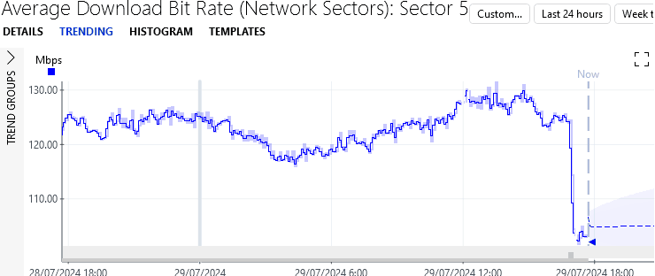

  10. On the DATA page of the Anomaly Feedback Tutorial - Average Download Bit Rate element, click the Generate Data button to generate data for a fifth network sector.
    You will see in the trend graph that network sector 5 experiences another small drop in bit rate. However, this time, no anomaly is generated for this size of decrease.
    Trend graph of Average Download Bit Rate for Sector 5 with a small drop at the end
  11. On the DATA page of the Anomaly Feedback Tutorial - Average Download Bit Rate element, click the Generate Data button to generate data for a sixth and final network sector.
    This sector experiences a large drop, and an anomaly is generated for it.
    This demonstrates that DataMiner's anomaly detection algorithm has learned when to generate an anomaly based on your feedback.

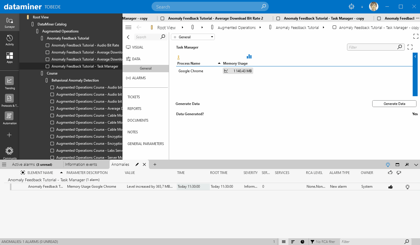

  1. Select the element Anomaly Feedback Tutorial - Task Manager in the Surveyor.
    This element simulates the Windows Task Manager, monitoring the memory usage of several processes. You want to be notified if this memory usage suddenly spikes.
    By right-clicking the element in the Surveyor and selecting Protocols & Templates > View alarm template 'Template', you will see that the element has an empty template associated with it. This allows DataMiner to suggest template improvements based on your feedback.

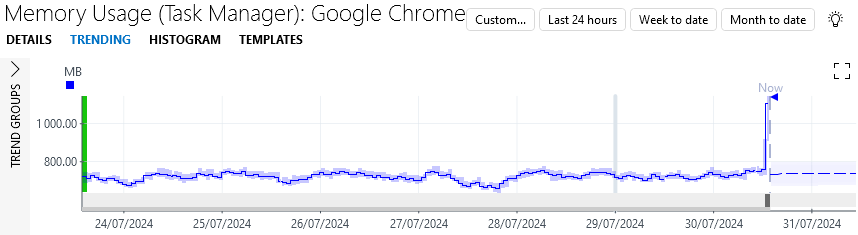

  2. Click the Generate Data button to generate data for a first process.
  3. Open the trend graph for the memory of the newly generated process by clicking the trend icon next to the Google Chrome parameter in the Task Manager table.
    You will see that the memory usage has fluctuated over the past week but remained stable overall. In the last hour, however, there is a significant spike. As indicated by the dark gray square below the trend graph and the entry in the Alarm Console, this jump has been detected as an anomaly.
    Memory usage of Google Chrome with jump at the end

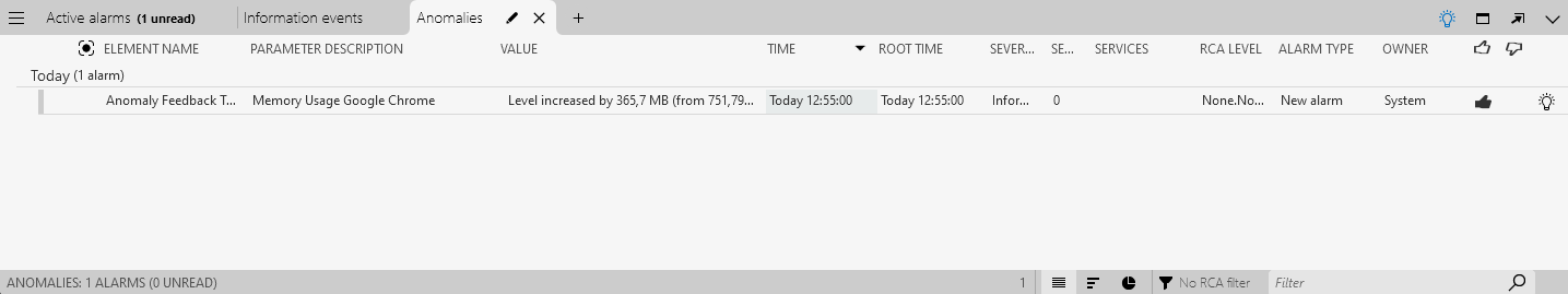

  4. Since this is the kind of anomaly you want to be notified of, go to the Anomalies tab in the Alarm Console, hover the mouse pointer over the level shift anomaly detected for Memory Usage Google Chrome, and select the thumbs up icon in the Feedback column.
  5. Click the light bulb icon next to the Feedback column.
  6. Select Improve alarm template from the list of follow-up actions.
    This will open a pop-up window with a proposed configuration for your anomaly alarm template, including suggested improvements to the anomaly alarms settings.
    In this case, it suggests enabling smart alarming for level increases, as you just provided positive feedback for this type of anomaly. This means that, in the future, an alarm will be generated when this type of anomaly is detected, rather than just a suggestion event.
    Pop-up window with proposed configuration
  7. Accept the suggested improvement by clicking Update alarm template in the lower-right corner of the pop-up window.
    The suggestion event now becomes a real alarm.
    Suggestion event is now an alarm

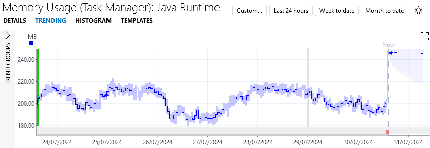

  8. On the DATA page of the Anomaly Feedback Tutorial - Task Manager element, click the Generate Data button to generate data for a second process, Java Runtime.
  9. Open the trend graph for the memory usage of Java Runtime by clicking the trend icon.
    The data again ends with an upward spike, but this time it is smaller. However, DataMiner still detects it as an anomaly, and because you enabled smart alarming for level increases, a critical alarm is generated.
    Memory usage of Java Runtime with relatively small jump at the end

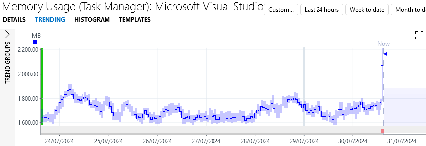

  13. On the DATA page of the Anomaly Feedback Tutorial - Task Manager element, click the Generate Data button a third time to generate memory usage data for the Microsoft Visual Studio process.

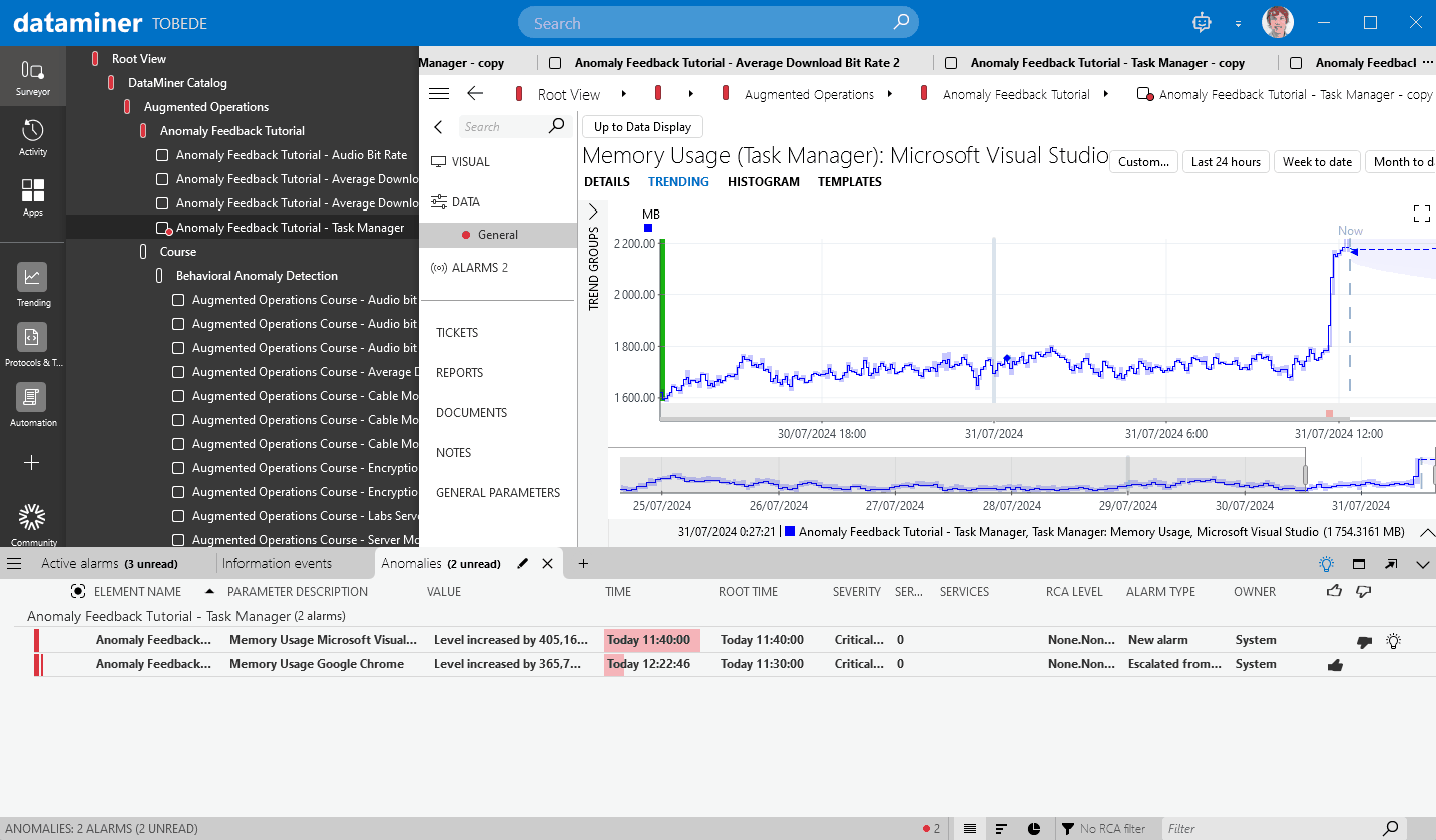

  14. Click the trend icon next to Microsoft Visual Studio to open the trend graph for the memory usage of this process.
    This jump is large in absolute terms (just over 400 MB) but small relative to the initial value of 1750 MB, representing an increase of about 23%.
    Memory usage of Microsoft Visual Studio a big jump at the end in absolute numbers, but relatively small compared to the baseline
  15. In the Anomalies tab of the Alarm Console, hover the mouse pointer over the level shift anomaly detected for the Memory Usage Microsoft Visual Studio parameter and select the thumbs down icon in the Feedback column.
  16. Click the light bulb icon next to the Feedback column and select Improve alarm template.
    This time, a relative threshold of 40% is proposed, meaning that anomaly alarms will be generated whenever the size of the jump is greater than 40% of the starting value. This relative threshold satisfies both your negative feedback on this last jump and on the smaller jump for Google Chrome. While the jump for Google Chrome was large relative to its initial value, the jumps for Java Runtime and Microsoft Visual Studio were small.
    Popup suggesting to set a relative threshold for level increases
    Select the clock icon on the Level increases row to compare the proposed configuration to the currently active configuration.
    The current configuration and the previous configuration
  17. To accept the suggested improvement, select Update alarm template in the lower-right corner of the pop-up window.
    The alarm for the Microsoft Visual Studio process disappears, while the alarm for the Google Chrome process remains.

    • A screenshot of the Anomalies tab in the Alarm Console with the feedback you provided for the anomalies.
Skyline will review your submission. Upon successful validation, you will be awarded the appropriate DevOps Points as a token of your accomplishment.

    • A picture of the trend graph with the detected anomaly.
    • An export of your trend graph, obtained by right-clicking the trend graph and selecting Export to CSV.
