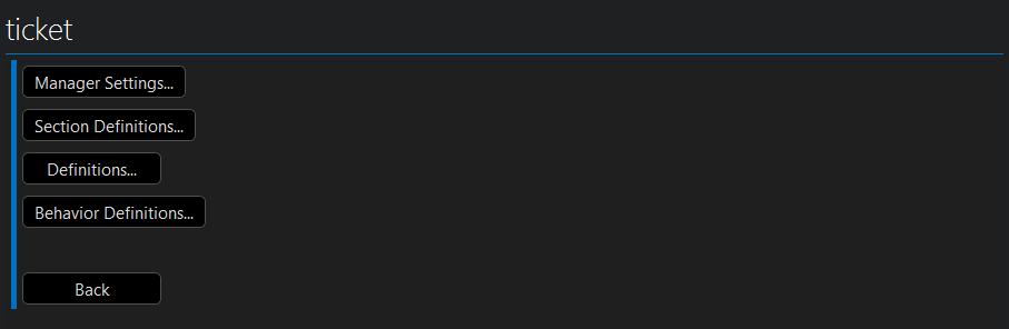

    A window with four buttons will be displayed.
    DOM Editor: edit module window
  3. Click Section Definitions.
