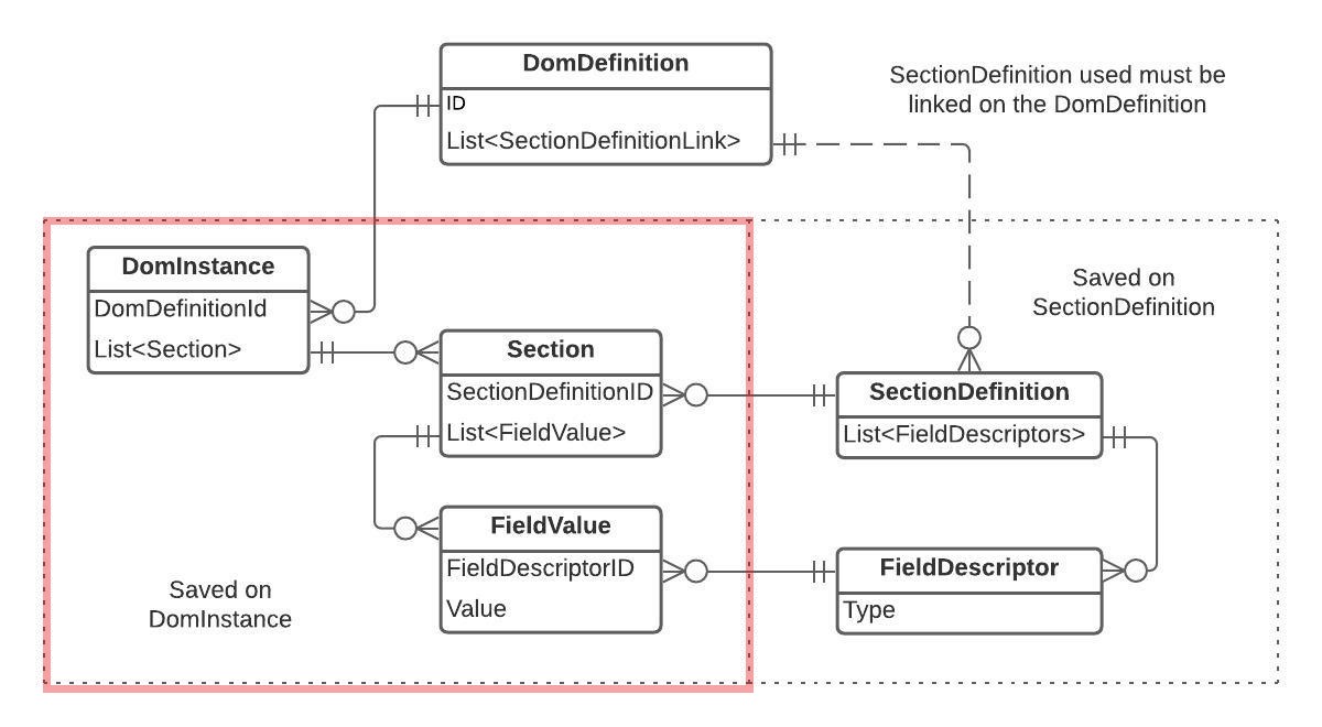

DomInstance object
A DomInstance object contains the Sections linked to the SectionDefinitions. These sections then contain a FieldValue for each FieldDescriptor defined in the SectionDefinitions.
Object relation diagram
