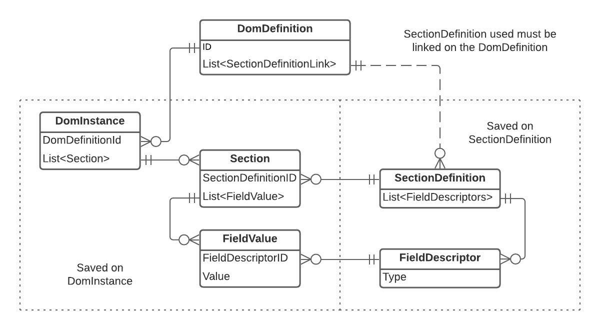

The following diagram illustrates the relation between these objects:
Object relation diagram
