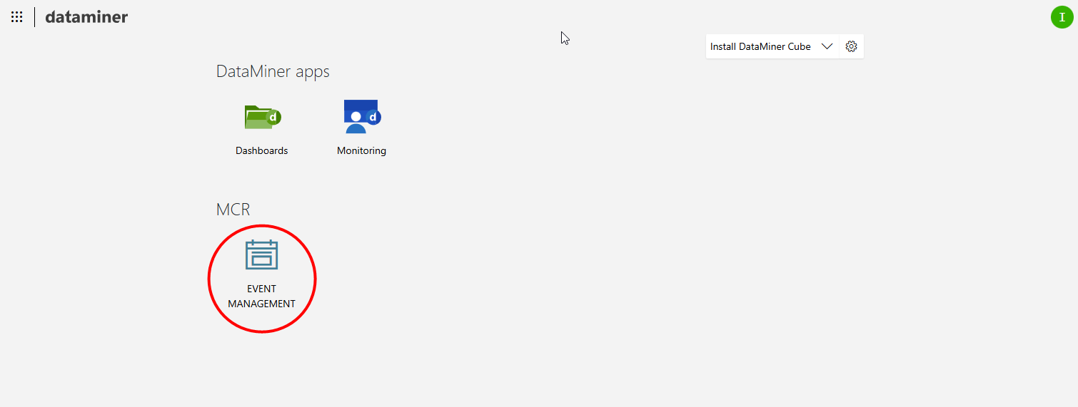

  3. Go to http(s)://[DMA name]/root, and select the Event Management application.
    Event Management application on DMA root page

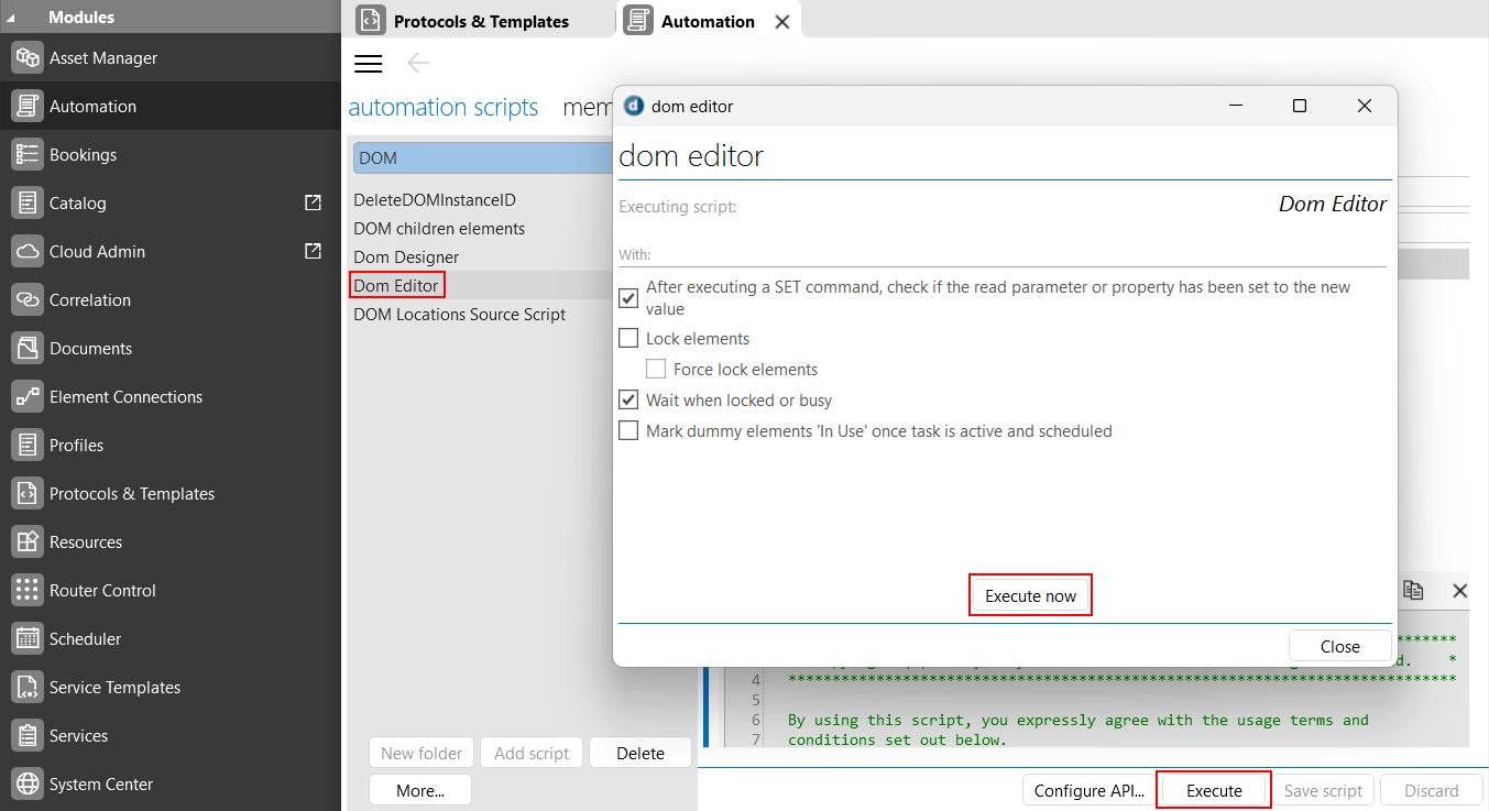

  1. Open the Automation module in DataMiner Cube.
  2. If necessary, use the filter box at the top to find the DOM Editor script.
  3. Select the script and click the Execute button on the right, then click Execute now.
    DOM Editor script execution

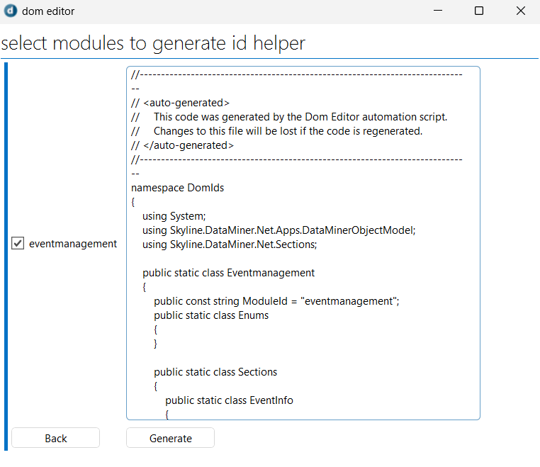

  4. Click the Generate Code button in the lower-right corner.
  5. Select the checkbox in front of the eventmanagement module.
  6. Click the Generate button.
  7. Copy the generated code to the clipboard.
    Generated code

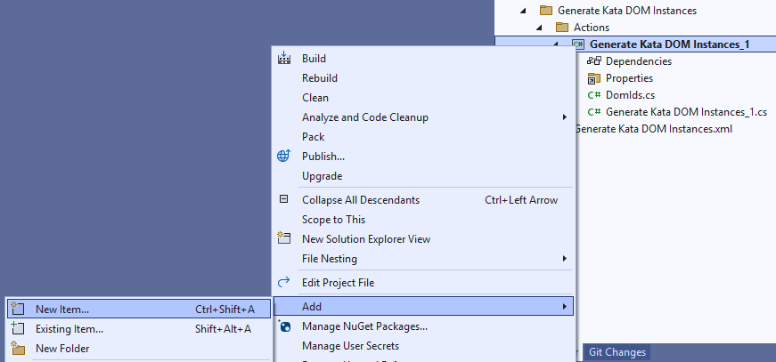

  1. Right-click the Generate Kata DOM Instances_1 project in the Solution explorer and select Add > New Item.
    Add a new item to the project
    If you have trouble accessing the project in the Solution Explorer, refer to Visual Studio troubleshooting.

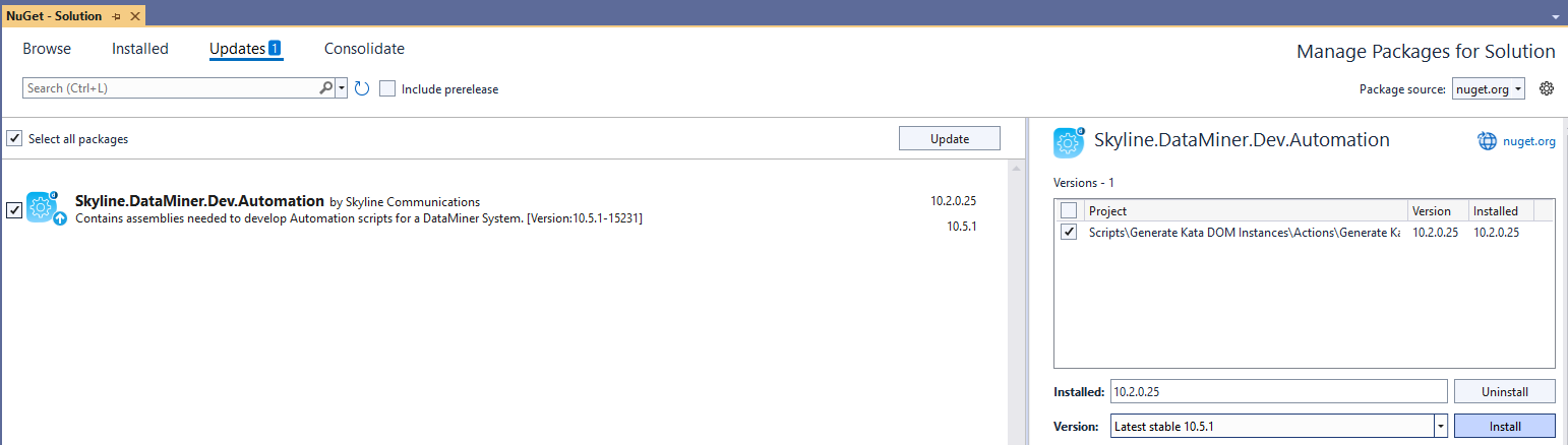

Visual studio will show some errors if you are not using the latest version for some of the NuGet packages. To resolve this:
  1. Open the NuGet package manager from the tools menu: Tools > Nuget Package Manager > Manage NuGet Packages for Solution.
  2. Go to the Updates tab and select the Skyline.DataMiner.Dev.Automation package.
  3. On the right, select version 10.3.10 (or higher) and click the Install button.
    Install version 10.3.10 or higher

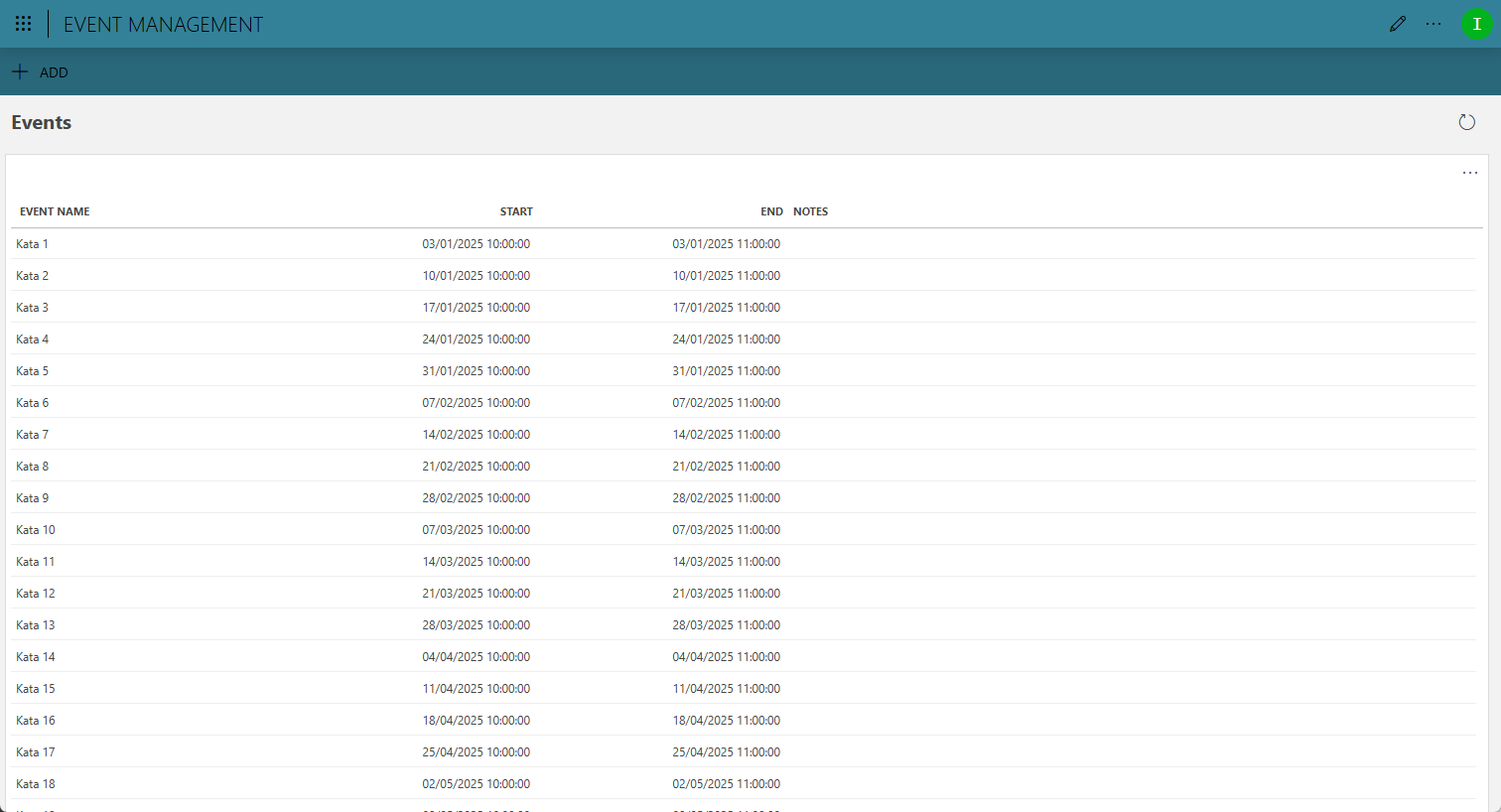

Step 4: Test the code
  1. Go to the Event Management application.
  2. Verify whether no entries are present.
  3. In Cube, execute the Generate Kata DOM Instances script.
    A series of events will be generated and shown in the app.
The events table is not updated automatically. To refresh the table, use the refresh button in the upper right corner.
