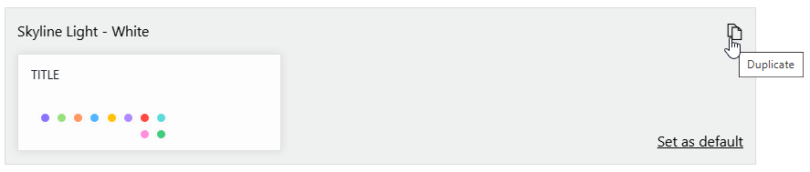

    • If a theme already exists that looks similar to what you have in mind, use the duplicate button to start from a duplicate of that theme.
      Duplicate theme button

  5. Prior to DataMiner 10.2.8/10.2.0 [CU6], to set the new dashboard theme as the default theme, click the Set as default toggle button.
    From DataMiner 10.2.8/10.2.0 [CU6] onwards, you can set a theme as the default by hovering the mouse pointer over the theme in the settings window and selecting Set as default.
