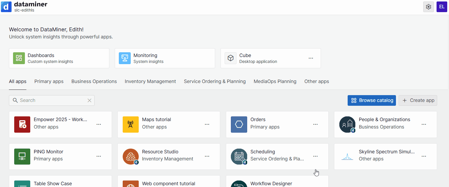

It is possible to organize the apps on the DataMiner landing page in different sections.
DataMiner landing page in DataMiner 10.5.9
At present, it is only possible to create new sections by changing the configuration of the apps in JSON. However, you can add new apps to existing sections directly from the DataMiner landing page.
Creating a new app under an existing section

From DataMiner 10.4.0 [CU18]/10.5.0 [CU6]/10.5.9 onwards:
Open the tab in which you want the app to appear.
In the upper-right corner of the low-code apps section, click Create app.
The app will be added to the selected section automatically.
