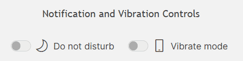

Two toggle switches
Toggle components in DataMiner 10.5.3
To configure the toggle component:
  1. In the Component > Settings pane, determine whether the component's default value should be "false" (toggle switch disabled) or "true" (toggle switch enabled). By default, this is set to "false".
  2. Optionally, fine-tune the component layout. In the Component > Layout pane, the following options are available:
    • Label: Text that will be displayed next to the toggle switch.
    • Icon: Icon that will be displayed next to the toggle switch.
Component actions
When you have added a toggle component to a low-code app, you can configure the following component action in your low-code app to interact with the component:
  • Set value: Allows you to set the current value of the component to either a static value (true, false, or empty) or data input (variables of type boolean).
