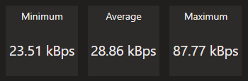

This component displays the minimum, average and maximum value of one or more trended parameters.
Trend statistics
Trend statistics component in DataMiner 10.4.5
