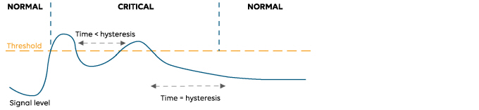

With alarm threshold hysteresis, you can fine-tune the sensitivity of your alarm thresholds by defining how long a parameter has to be below or above a certain threshold before the DataMiner System is allowed to consider it as being below or above that threshold.
Alarm hysteresis
DataMiner supports two types of hysteresis:
  • Clear hysteresis: Delaying the moment when an alarm is cleared, i.e., the moment when the severity of an alarm decreases.
  • Alarm hysteresis: Delaying the moment when the severity of an alarm increases.
