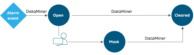

About automatic alarm clearing
By default, a DataMiner alarm of which the severity returns to normal is automatically cleared by the system.
Automatic alarm clearing

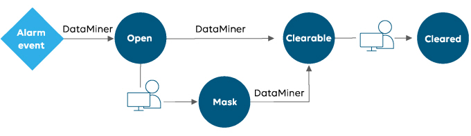

About manual alarm clearing
A DataMiner alarm of which the severity returns to normal can also be kept in a “clearable” state until a user clears it by hand. This prevents alarms from disappearing from the system before being explicitly cleared by a user.
Manual alarm clearing
Alarms that reoccur before they have been cleared by a user will be linked to the original alarm. In other words, when the same alarm occurs several times in a short period of time, it will only have to be cleared once.
