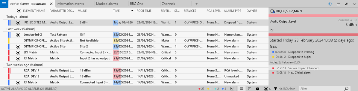

For each alarm tab, you can open a side panel in the Alarm Console showing the real-time value and history of a selected alarm.
Alarm Console side panel
Collapsible side panel of the Alarm Console in DataMiner 10.6.5
You can open the side panel of an alarm tab in three ways:
  • Right-click an alarm, and select Show side panel.
  • Select Show side panel in the Alarm Console settings menu. See Alarm Console settings.
  • Double-click an alarm in an alarm tab, if the Alarm double-click action user setting is set to Open side panel. See Alarm Console settings.

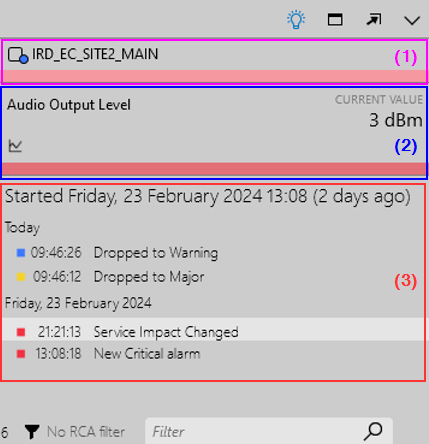

In the side panel:
Side panel
  • The top section contains the name of the element in alarm and an overview of its alarm state in the last twenty-four hours (1). Click this section to open the element card.
  • Below this is the parameter section, which contains the current value of the parameter and an overview of the parameter state in the last twenty-four hours (2). If the parameter in alarm is trended, click this section to see the trend graph.
  • The bottom section displays more information about the alarms in the alarm tree (3). Click any of the items in the tree to open the alarm card with the selected item highlighted. See Alarm cards.
