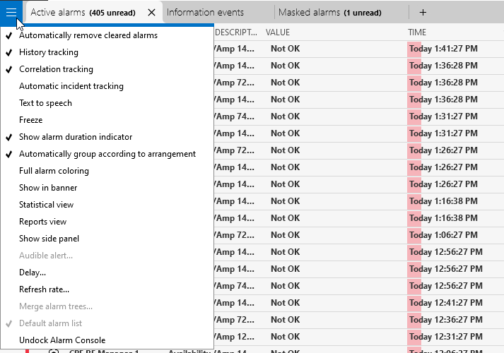

Alarm Console settings
To access specific settings for the Alarm Console, click the hamburger button in the upper-left corner of the console.
This will open a menu containing the settings explained below.
Alarm Console settings menu in DataMiner 10.6.5

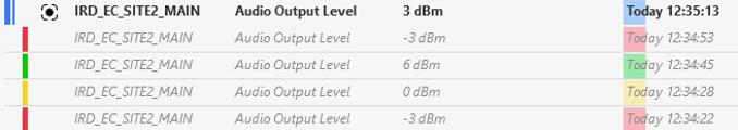

Merge alarm trees
This setting is only available if History tracking is enabled and Automatically remove cleared alarms and Freeze are disabled in the alarm tab.
When these settings are used, by default, when an alarm is cleared and then reappears, this results in a separate alarm tree. Activating Merge alarm trees combines these alarm trees, which can result in a better overview, e.g., in a sliding window tab.
Merged alarm trees in DataMiner 10.6.5
When you activate this option, you can also select an additional option to only merge alarm trees in case the time between the alarm trees is less than a particular time span (between 1 second and 1 day).
