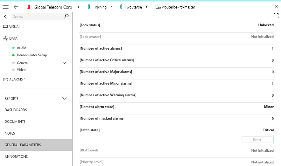

For each element in DataMiner, a GENERAL PARAMETERS page can be displayed in Cube. This page contains parameters that apply to the DataMiner element itself, rather than the device the element represents. Depending on the type of element, some general parameters may or may not be available. An overview of these parameters can be found below.
General parameters page in DataMiner 10.6.5

[Lock status]
This general parameter indicates whether the element is locked or unlocked.
[Lock owner]
If an element is locked, this general parameter indicates the user who locked the element. Otherwise the parameter is "Not initialized".
[Number of active alarms]
This general parameter indicates how many alarms are present on the element.
[Number of active ... alarms]
These general parameters indicate how many alarms of particular alarm levels are present on the element.
[Element alarm state]
This general parameter indicates the overall alarm state of the element, i.e., the alarm state of the non-masked alarm with the highest alarm level on the element.
[Number of masked alarms]
This general parameter indicates how many masked alarms are present on the element.
[Latch state]
This general parameter indicates the highest alarm level that has occurred on the element since the last time the latch state was reset. To reset the latch state, click the Reset button underneath this parameter.
[RCA Level]
If the element is part of an RCA chain, this general parameter indicates its RCA level.
