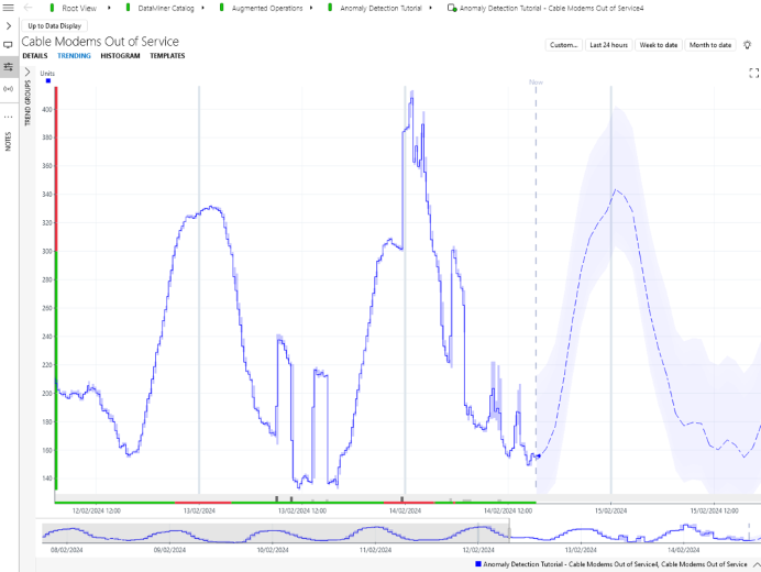

If the DataMiner Agent uses Storage as a Service or a self-managed Cassandra-compatible database, trend graphs can show how the value of a parameter in the graph is most likely to evolve in the future.
The current point in time is displayed with a vertical dashed line marked as "Now". This line is updated every 2 seconds. The trend prediction starts from the "Now" line.
Trend graph in DataMiner 10.4.5
The predicted trend is displayed as a line surrounded by three shaded areas:
The largest shaded area shows how the parameter will evolve with 95 % probability
The middle area shows the evolution with 90 % probability, and
The smallest area shows the evolution with 80 % probability.
