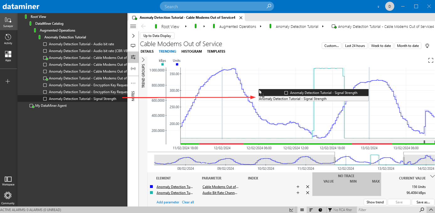

To add parameters with the parameter pane:
  1. Click Add parameter or drag an element or parameter onto the graph from the navigation pane.
    Add parameter
    Trend graph in DataMiner 10.6.5
  2. Specify the element and parameter, if necessary. For a table parameter you may also need to specify the index.
  3. Repeat from step 1 until all necessary parameters have been added.
