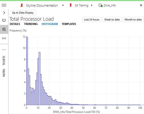

Histogram page in DataMiner 10.6.5
In a histogram:
  • The X-axis represents the parameter value, shown in intervals.
  • The Y-axis represents the number of times the parameter value occurred in the given time span.
The histogram right-click menu allows you to:
  • Change the type of Y-axis from the default setting of absolute values (the number of occurrences) to relative values (% of total occurrences), by deselecting Use absolute frequency.
  • Print the histogram.
  • Save the histogram as an image.
  • Copy the histogram as an image to the clipboard.
  • Export the histogram to a CSV file.
