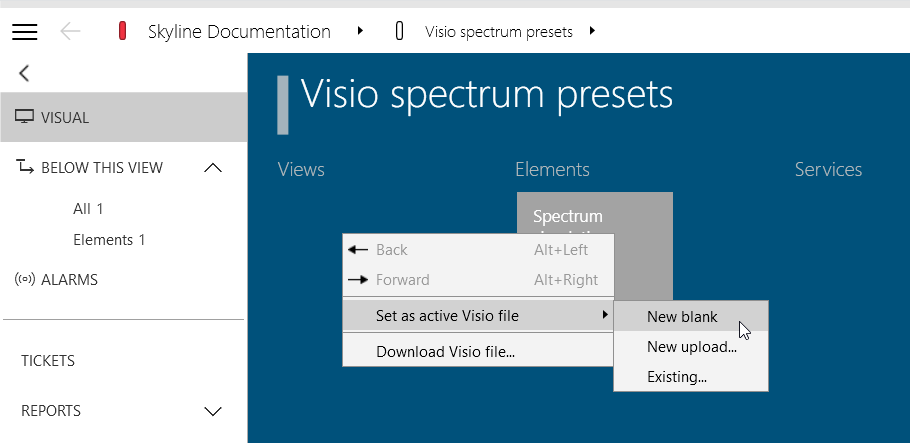

Step 3: Add a blank Visio file to the view
Open the new view on the Visual page.
Right-click the Visual page, and select Set as active Visio file > New blank.
In the New Visio file pop-up window, click Yes.
At this point, your Microsoft Visio application should start up automatically, and you can start modifying your new Visio file.

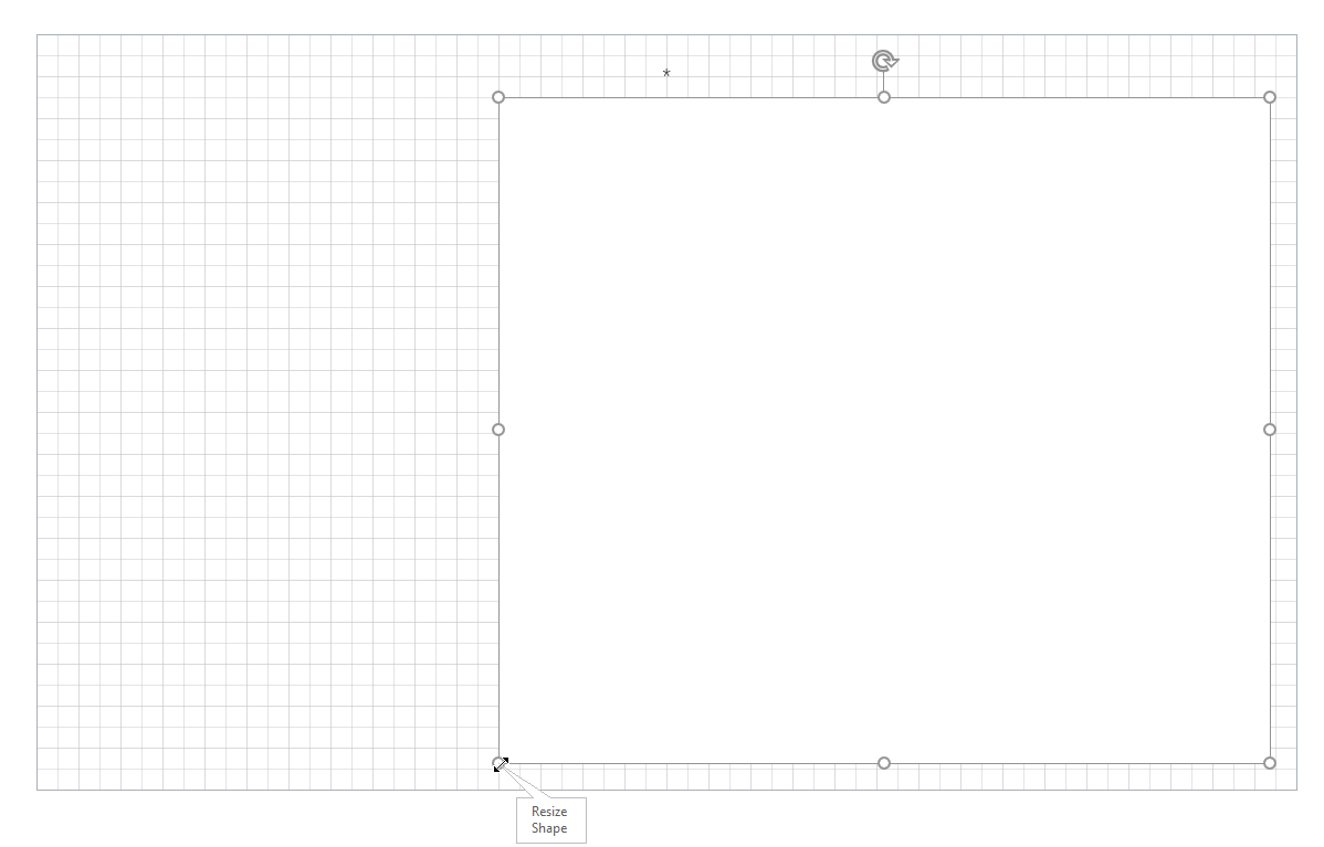

In the Home tab of the ribbon, click the rectangle in the Tools section.
Draw a large rectangle on your page by clicking and dragging the mouse on it.

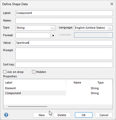

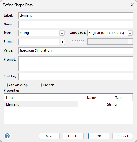

In the pop-up window, set the Label field to
Elementand the Value field to the name of the spectrum simulation element you created earlier, e.g.Spectrum Simulation.
Click the New button to add another shape data field with label
Componentand valueSpectrum.
Click OK to close the Define Shape Data window.

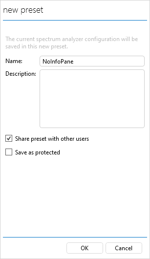

In the spectrum sidebar on the right, select the Presets tab and click the Manage button at the bottom.
Click the New button.
Configure the preset:
Give the preset the name
NoInfoPane.Select the Share preset with other users checkbox.
Click OK.
Click OK again to close the Manage presets pane.

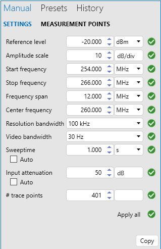

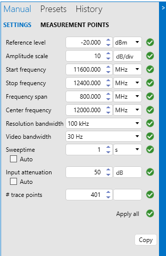

In DataMiner Cube, navigate to the Spectrum Analyzer data page of your spectrum simulation element.
In the Manual tab of the spectrum sidebar, change the settings to the desired values. e.g. for a satellite signal this could be a 12GHz center frequency and a 800MHz frequency span. For this tutorial, you can leave the other settings as they are.
- Center frequency
12GHz. - Frequency Span
800MHz.

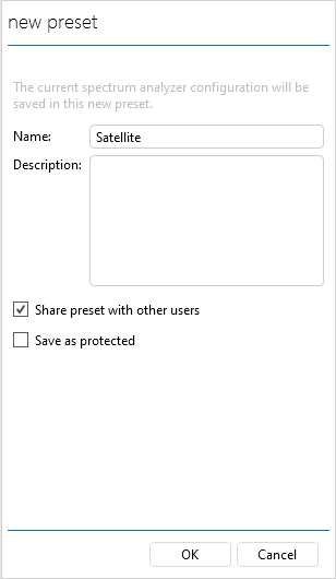

Satellite.Select the Share preset with other users checkbox.
Click OK.
Repeat the steps above for a second signal. E.g. For a cable signal, we could use a center frequency of 260 MHz and a frequency span of 12 MHz. Give it the name
Cable.- Center frequency
260MHz. - Frequency Span
12MHz.

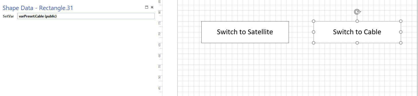

Resize the shape linked to the spectrum analyzer control to make room for buttons.

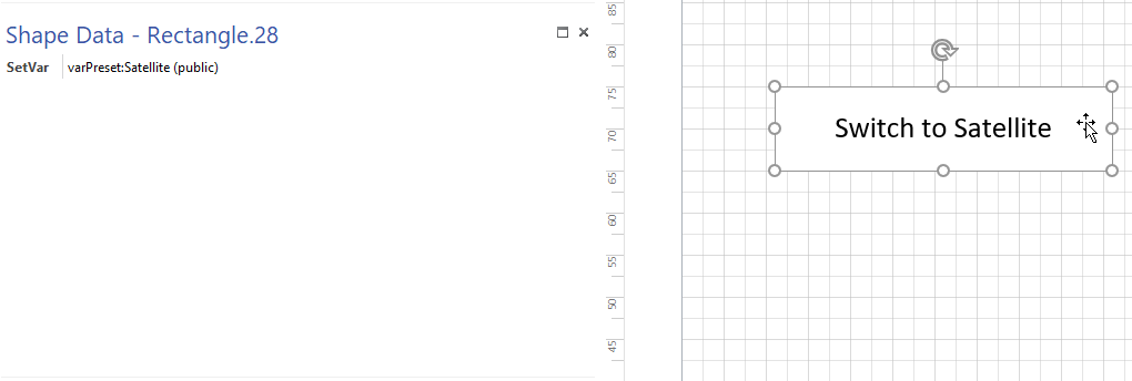

Create a small rectangular shape, and add the text
Switch to Satellitein the shape.Add a shape data field to this shape, with label
SetVarand valuevarPreset:Satellite (public).In this value,
varPresetis the name of the session variable, andSatellite (public)refers to the name of the spectrum preset. The(public)suffix is needed to indicate that this is a shared preset.
Duplicate this shape by using copy/paste and change the text and shape data of the copy so it refers to the
Cablepreset.

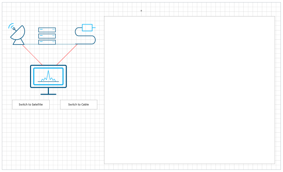

Step 9: Draw a graphic representation of the setup
Add a number of images in the Visio file that represent the setup in your system.
To quickly get suitable images, you can use the Skylicons. In the example below, the dual-color versions of the cable, dish, monitor, spectrum, and stacked devices skylicons were used.
To add images, you can drag them from a location on your computer where you stored the images and drop them onto the Visio drawing.
You can also add images by selecting the Insert tab in the Visio ribbon, and then selecting Pictures. You can then navigate to the images you want to add and select them.
Draw lines that represent the connections between the components:
In the Home tab of the ribbon, click the downward arrow next to the rectangle in the Tools section, and select Line instead.
Drag lines between the shapes to make it look as if they are connected.
To enhance the visualization, change the line color for the connections to the image that represents the spectrum analyzer:
In the Home tab of the ribbon, select the Pointer Tool in the Tools section.
Select the line for which you want to change the color or thickness.
In the Shape Styles section of the Home tab, click the Line dropdown, and select the color you want to use.
If you want to also change the thickness of the line, open the Line dropdown again, go to Weight, and select the thickness you want to apply.

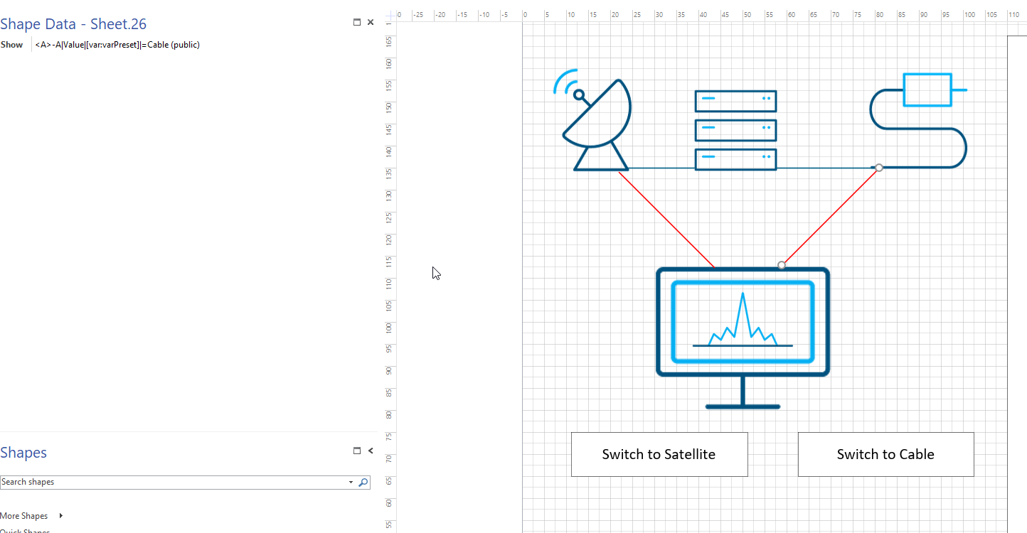

Step 10: Show only the current selection
To indicate which point of the setup is currently measured, you will now configure one of the lines to be hidden depending on the button that was last clicked.
Select the line between the satellite dish image and the spectrum analyzer image and define a shape data field with label
Showand value<A>-A|Value|[var:varPreset]|=Satellite (public).Tip
For more information on the Show condition format, see Extended conditional shape manipulation actions.
Add a shape data field with label
Showand value<A>-A|Value|[var:varPreset]|=Cable (public)for the connection line between the spectrum analyzer and the cable image.
Make sure no more shapes are selected.
Save the Visio file.
On the Visual page in DataMiner Cube, click the buttons and verify whether the lines are correctly shown or hidden when the presets are switched.
