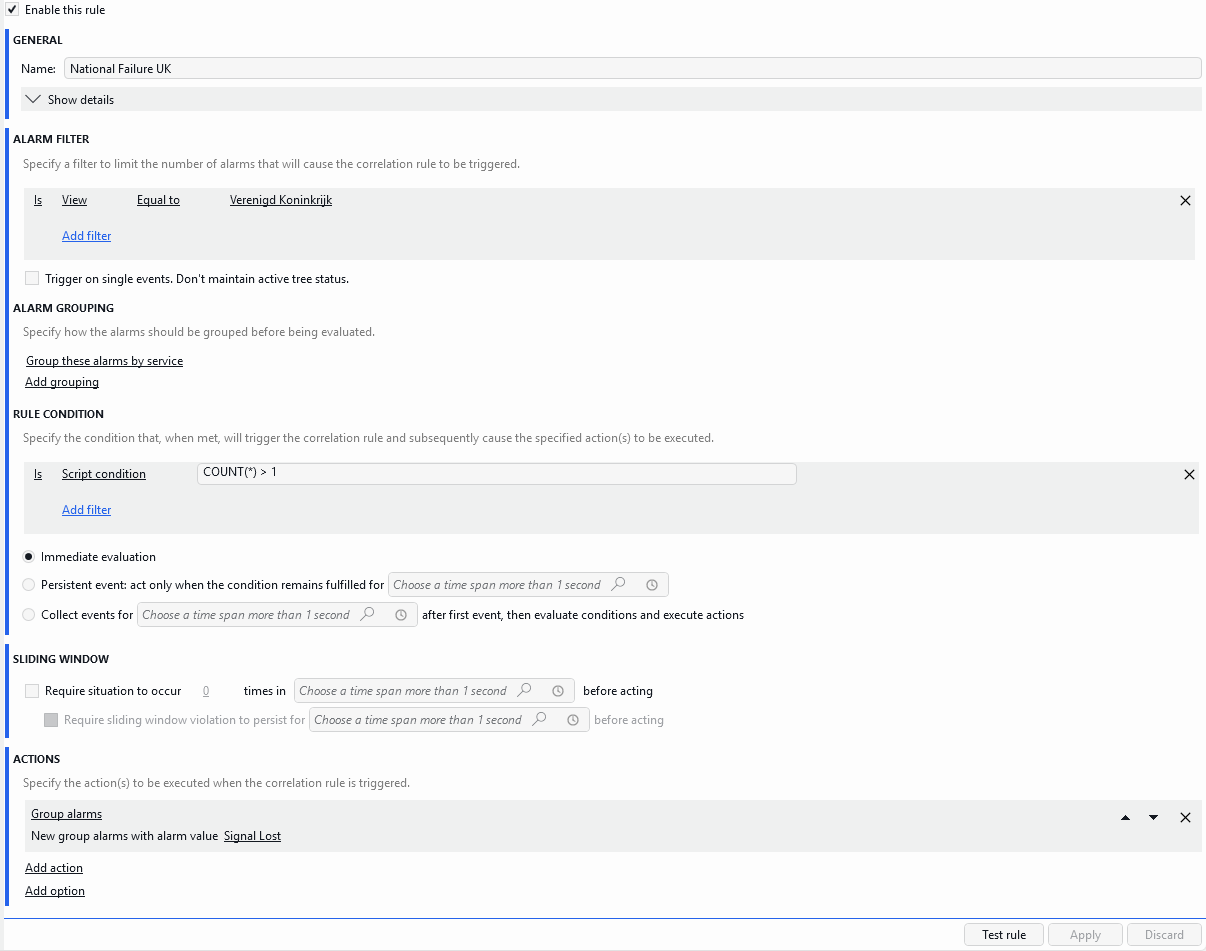

Correlation : Alarm grouping [ID 44973]
When configuring a correlation rule, it is now possible to specify that a Group alarms action has to be executed when that rule is triggered.
This action is similar to the New alarm action. When the rule is triggered, a new alarm will be generated, but in the case of the Group alarms action, the alarm will be linked to the DataMiner element. The value of the alarm can be set in the action itself.
Correlation rule configured with the Group alarms rule action

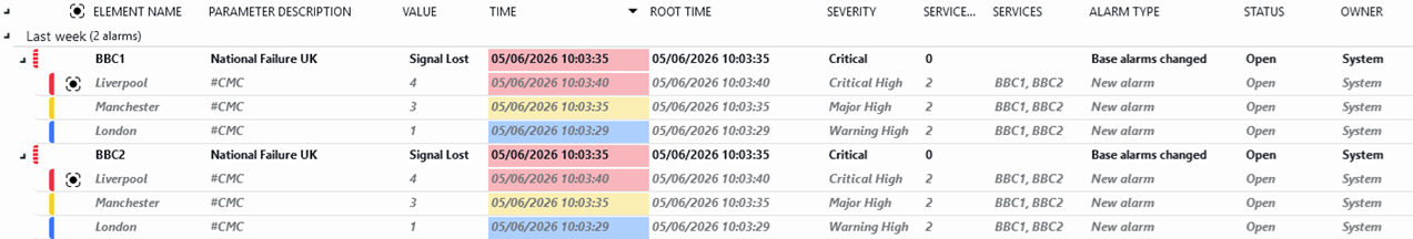

When a group alarm appears in the Alarm Console, the following fields will be updated:
  • The severity will be set to the severity of the base alarm with the highest severity. This severity will be shown in the Severity column, and will also be indicated by the color of the alarm icon.
  • The parameter name will be set to the name of the correlation rule.
  • The element name will be changed according to the configuration of the correlation rule:
    Correlate across DMAs option Alarm grouping Element name
    Selected Not defined Name of the cluster
    Selected Defined Name of the grouped object
    Not selected Not defined Name of the DataMiner Agent
    Not selected Defined Name of the DataMiner Agent + Name of the grouped object
Alarm Console: two group alarms have been generated
