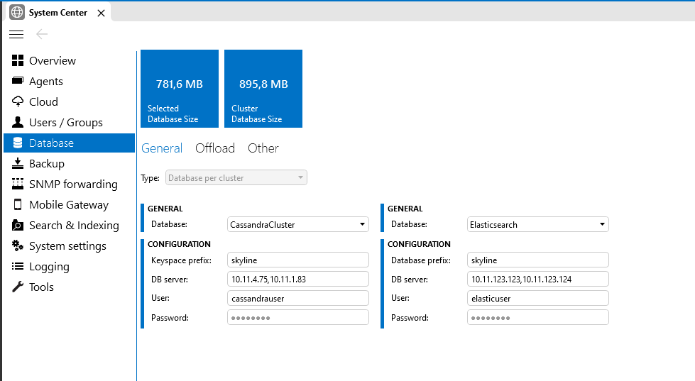

For a Cassandra cluster database (i.e., one Cassandra cluster that is used as the general database for the entire DMS, rather than one Cassandra cluster per DMA), configure the settings as follows:
  1. Go to Apps > System Center > Database.
    From DataMiner 10.3.0 [CU15]/10.4.0 [CU3]/10.4.6 onwards, the Database > General page is no longer available if you are using a DaaS system, as it is not possible to customize the database configuration of a DaaS system.
  2. Choose Type: Database per cluster.
  3. Specify the following database settings for the Cassandra nodes:
    • Database: The type of database, i.e., CassandraCluster.
    • Keyspace prefix or Name: The prefix that the DataMiner System will use to create the keyspaces.
      The prefix has a maximum length of 20 characters. Prior to DataMiner 10.3.0 [CU5]/10.3.8, it has a maximum length of 11 characters.
    • DB server: The IP addresses or hostnames of the nodes, separated by commas. There is no need to specify a port. Specifying a custom port is not supported, and the default port 9042 will be used whether you specify it or not (see Configuring the IP network ports).
    • User: Username with which the DMA has to log on to Cassandra.
    • Password: Password with which the DMA has to log on to Cassandra.
  4. From DataMiner Cube 10.3.0/10.3.3 onwards, you can also specify the database settings for the indexing database.
    • Database: The type of database, e.g., Elasticsearch/OpenSearch.
    • Database prefix: The prefix that the DataMiner System will use to create the indices.
    • DB server: The IP addresses or hostnames of the indexing database nodes, separated by commas. If TLS is enabled, the full URL must be specified, e.g., https://elastic.mydomain.local. If no port is provided, the default port for the indexing database is used instead (see Configuring the IP network ports).
    • User: The username with which the DMA has to log on to the indexing database (if applicable).
    • Password: The password with which the DMA has to log on to the indexing database (if applicable).
      Cube Cassandra Cluster Configuration
      Database tab in System Center in DataMiner 10.3.3
  5. Click Save.

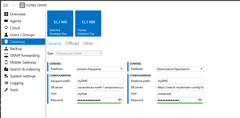

To configure the connection to an Amazon Keyspaces database, proceed as follows:
  1. In DataMiner Cube, go to System Center > Database.
  2. Specify the following database settings:
    • Type: Database per cluster.
    • Database: The type of database, i.e., Amazon Keyspaces.
    • Keyspace prefix: The name all Amazon Keyspaces will be prefixed with. This will be identical for all DMAs in the DMS.
      • Only alphanumeric characters are supported.
      • The prefix cannot start with a number.
      • The prefix has a maximum length of 20 characters. Prior to DataMiner 10.3.0 [CU5]/10.3.8, it has a maximum length of 11 characters.
    • DB Server: The URL of the global endpoint of the region your Amazon Keyspaces cluster is in. (e.g., cassandra.eu-north-1.amazonaws.com).
    • User: The username of your Amazon Keyspaces credentials.
    • Password: The password of your Amazon Keyspaces credentials.
  3. Click Save.
    Database configuration changes will not take effect until the Agent is restarted.
  4. Restart the DMS.
    The first restart after configuring Amazon Keyspaces can take up to 15 minutes on top of the normal startup time as the keyspaces and tables will be created. In case of trouble, you can find the relevant logging in the SLDBConnection.txt file.
Cube Database Configuration
DataMiner 10.3.3 example configuration

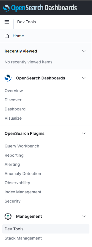

    2. Select the hamburger button and go to Management > Dev Tools.

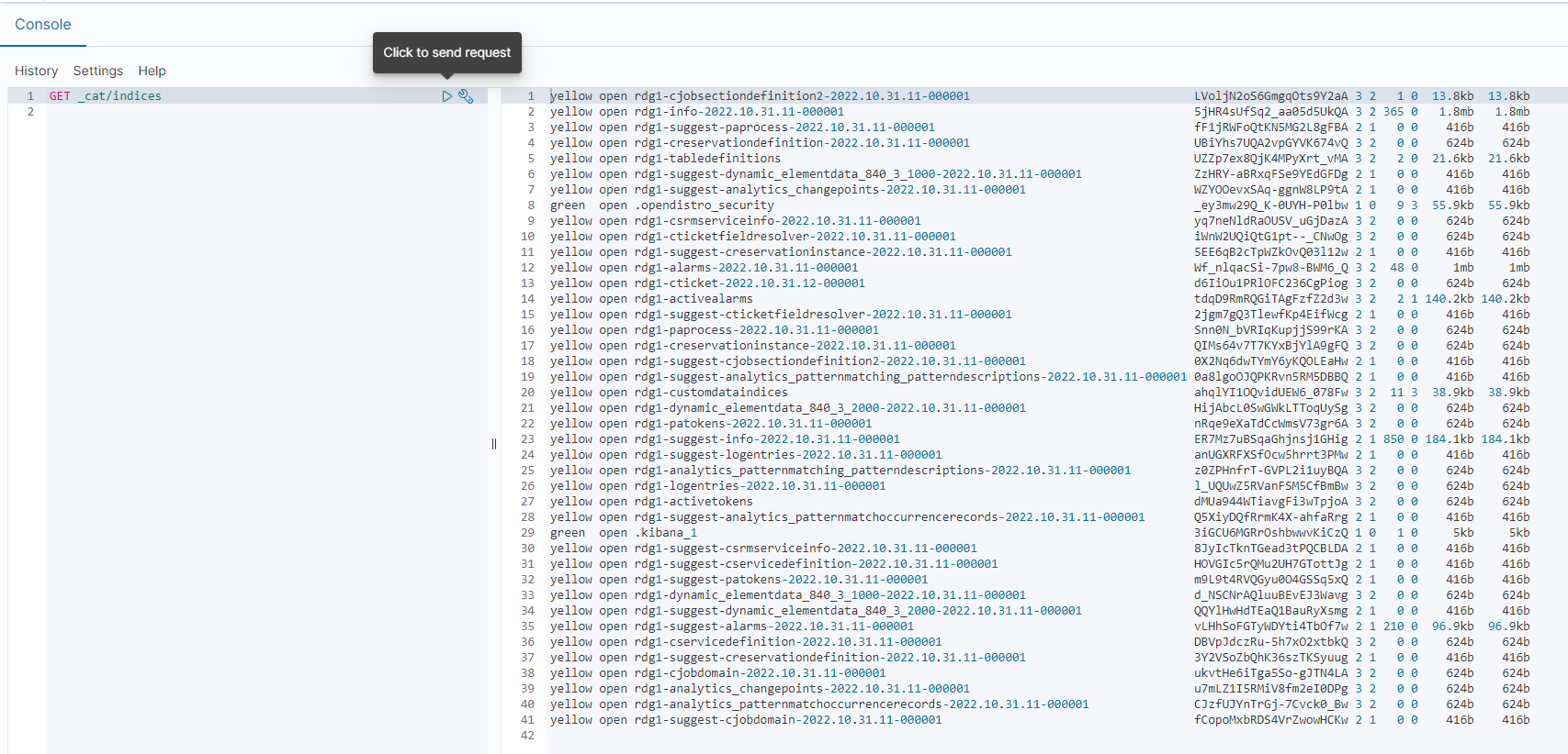

    3. Execute the GET _cat/indices query to check whether the DMS has created the necessary indices.
      CatIndices
    In the example screenshots, the cluster health is set to yellow because only one node is used. Single-node clusters are always displayed in yellow.
