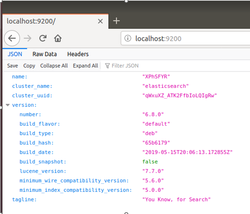

    • To check if the Elasticsearch service is running, check the logs under /var/log/elasticsearch/ or send an HTTP request to NodeIP:9200.
      The HTTP request response should be as follows:
      Elasticsearch example

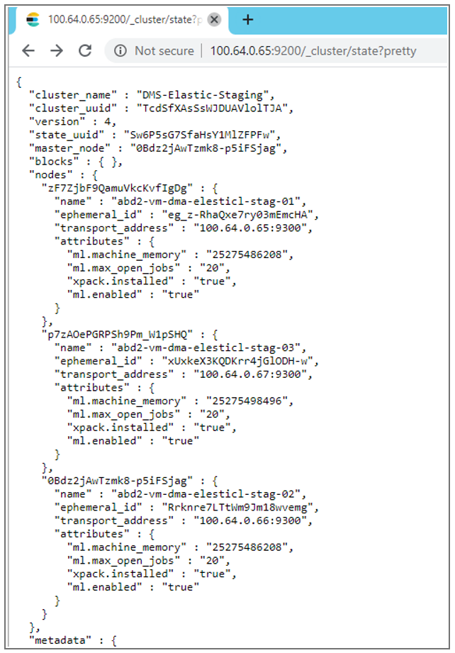

    • Connect to one of the nodes using a web browser, and check the cluster status by going to http://<NodeIP>:9200/_cluster/state?pretty.
      The response should be as follows:
      Elasticsearch example1

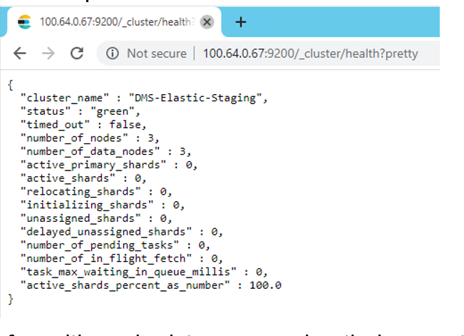

    • To check the cluster health status, go to http://<NodeIP>:9200/_cluster/health?pretty.
      Elasticsearch example2
