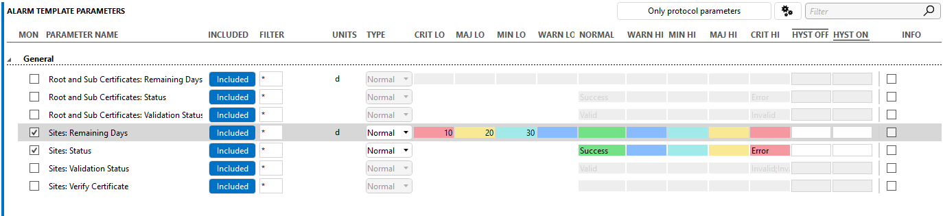

  5. Create an alarm template to monitor the parameter Remaining Days of the protocol, and assign it to the element.
    Alarm template configuration
    Alarm template editor in DataMiner 10.6.5
