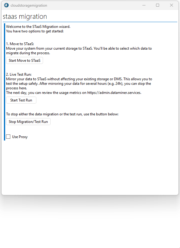

  4. Initialize the migration:
    1. Optionally, configure a proxy for the migration if necessary. This is supported from DataMiner 10.4.6 onwards.
    2. Click Start Move to STaaS to initialize the migration.
  5. Start the migration:
    • Select the desired storage types for migration.
      Prior to DataMiner 10.5.4/10.6.0, certain custom data, such as DOM, SRM, and Analytics data, are grouped together under the custom_data storage type and can only be migrated as a single category. From DataMiner 10.5.4/10.6.0 onwards, you can select specific storage types such as DOM, SRM, and Analytics, allowing you to migrate this data separately.
      For systems with a lot of real-time trending, we urge you to consider if you really need this data to be migrated. This data is typically only stored for 1 day, so when there is a lot of data, this gives an overhead on the rest of the types that need to be migrated, and this can cause the migration to take longer.
    • Click Start migration to start the migration.
      CloudStorageMigration
      CloudStorageMigration script in DataMiner 10.5.4
    The script will initiate the migration process, but the migration itself will not be completed immediately.
