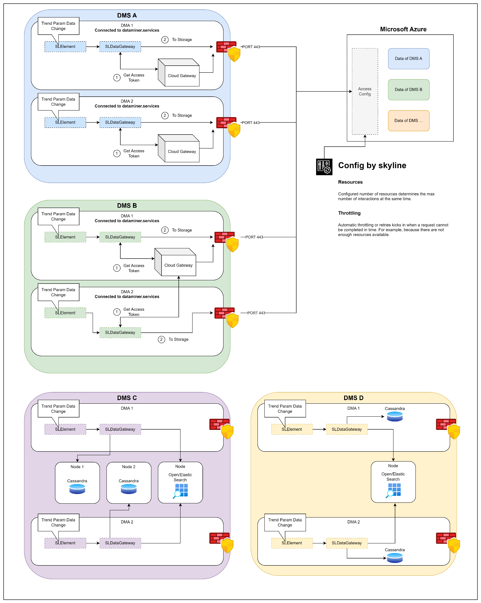

The diagram below provides an overview of two clusters using STaaS versus Cassandra.
STaaS vs Cassandra
  • DMS A and B: Interaction with STaaS
    The diagram provides a compact visualization of how DMS A and DMS B interact with STaaS. The SLDataGateway facilitates the exchange of data with STaaS. Each STaaS-connected Agent requires a secure HTTPS channel to the STaaS database, hosted on a Microsoft Azure endpoint (West Europe or UK South).
    This secure connection is established via port 443 and authenticated using an access token provided by the Cloud Gateway. Think of this token as a "key" that unlocks the secure communication channel.
    • DMS A: Both Agents in the cluster have a Cloud Gateway installed.
    • DMS B: Only one Cloud Gateway is installed in the cluster, which is the minimum required per cluster.
  • DMS C and D: Cassandra-related databases
    The visualization for DMS C and D highlights their interaction with Cassandra-related databases.
    • DMS C: Communicates with a Cassandra cluster that also includes OpenSearch/Elasticsearch.
    • DMS D: Uses local Cassandra nodes and an external OpenSearch/Elasticsearch node.
All communication between the DMS and the databases is routed through SLDataGateway.

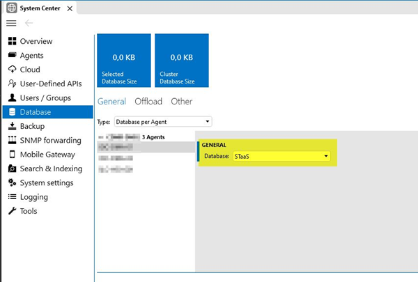

  • In DataMiner Cube:
    1. Navigate to System Center > Database > General.
    2. Check if "STaaS" is entered in the Database field.
      System Center - Database set to STaaS
      System Center in DataMiner 10.6.4
      The type of database (i.e., Database per cluster or Database per Agent) is not relevant, as all data from the cluster will be stored the same way.

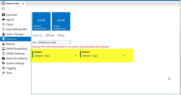

      For example:
      System Center - Database per cluster

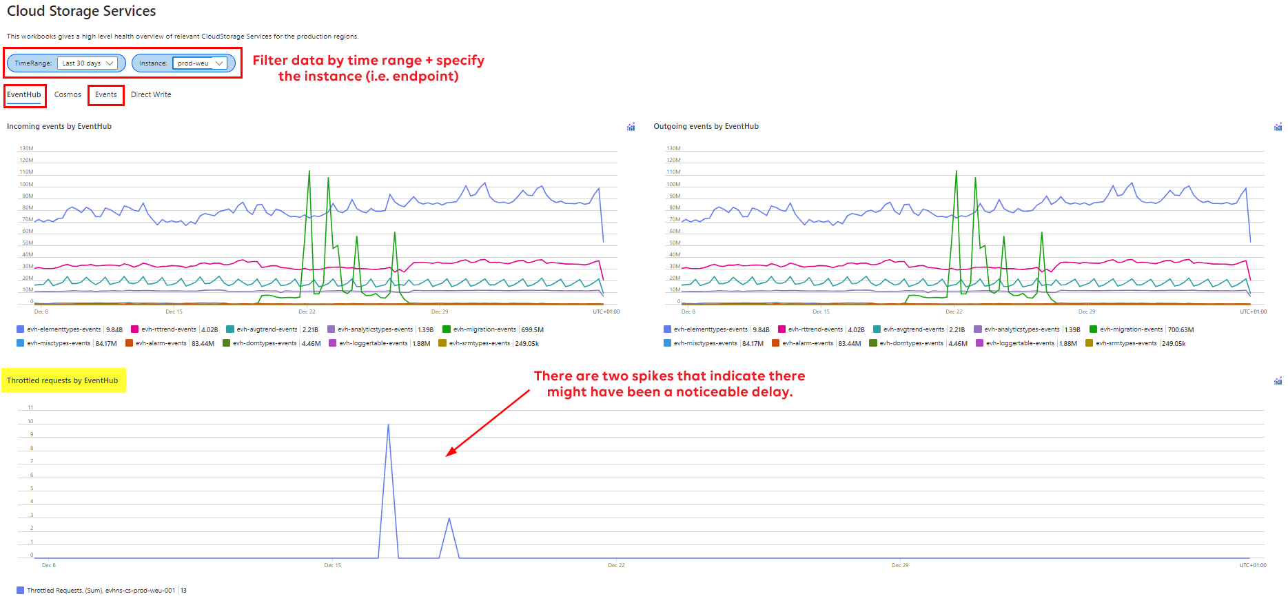

Slow interaction/performance
Impact:
  • Overall system slowness.
  • Inability to retrieve trend graphs, alarm history, etc.
Reason:
  • High volume of interaction with dataminer.services.
  • The upload/download bandwidth of the local internet connection is insufficient to handle the high load, resulting in queueing.
  • dataminer.services cannot handle the high load, resulting in queueing.
  • (Poor) integration design.
Actions:
  • Navigate to the C:\Skyline DataMiner\Logging folder of your DataMiner Agent, open the SLCloudStorage.txt log file, and look for throttling warnings.
  • If the DataMiner System relies heavily on inter-element or inter-automation communication, consider using the InterApp framework as a better architectural choice.
    If SLNet performance issues arise because of large interactions when using SLNet Subscriptions, ensure that you are using DataMiner version 10.3.12 or higher. InterApp communication efficiency has been significantly improved in this version, which also directly impacts interactions with STaaS.
