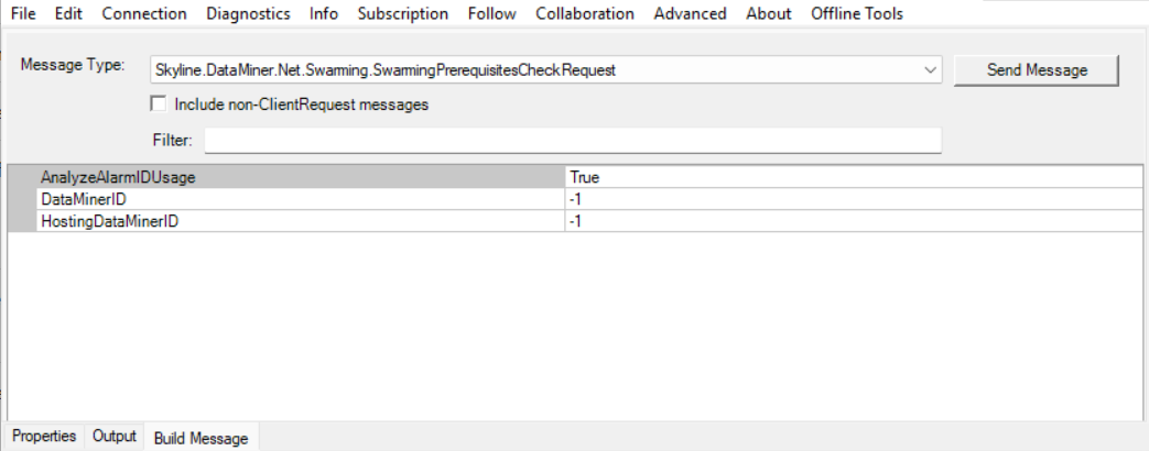

Go to the Build Message tab of the main window of the SLNetCLientTest tool.
In the Message Type dropdown list, select the message Skyline.DataMiner.Net.Swarming.SwarmingPrerequisitesCheckRequest.
By default, the DataMinerID property for the message will be set to -1, which means that the entire cluster will be checked.
If you do not want to check the alarm ID usage yet, but you want to run a first, quicker check for the other prerequisites, you can set the AnalyzeAlarmIDUsage property to false.
Swarming prerequisites check in DataMiner 10.5.3Click Send Message.

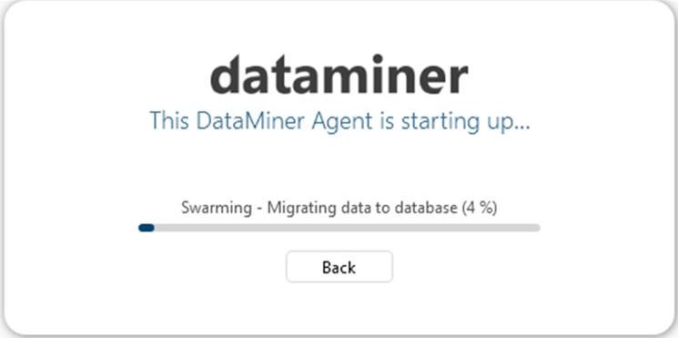

During DataMiner startup, the existing element XML files will be moved from the disk to the database. This can take several minutes. While this is happening, a message will be displayed on any clients that are trying to connect.
